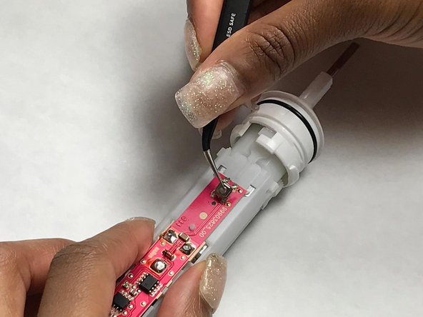

    • Using the pliers, rotate the head base 90 degrees counterclockwise and remove core from the handle.
  2. Oral-B Vitality Power Button Replacement: crwdns2935265:02crwdnd2935265:01crwdnd2935265:01crwdne2935265:0
    • Locate the 4 terminals connecting the power button to the circuit board.
  3. Oral-B Vitality Power Button Replacement: crwdns2935265:03crwdnd2935265:01crwdnd2935265:03crwdne2935265:0 Oral-B Vitality Power Button Replacement: crwdns2935265:03crwdnd2935265:02crwdnd2935265:03crwdne2935265:0 Oral-B Vitality Power Button Replacement: crwdns2935265:03crwdnd2935265:03crwdnd2935265:03crwdne2935265:0
    • Desolder the 4 terminals and remove the old button.
    • Remove as much of the old solder as possible.
  4. Oral-B Vitality Power Button Replacement: crwdns2935265:04crwdnd2935265:01crwdnd2935265:01crwdne2935265:0
    • Attach the new button by soldering the 4 terminals with new solder.

In my case no need to change the button, just redo the solder and this is it.
the vibration has damaged the solder.

Before unsoldering the button, you can understand if it is good or not just bypassing it with a wire: with a copper wire you can touch two pins of the button (one on the right side, on on the left side); if the toothbrush starts and stop on each touch of the wire, the problem is the button. I recognize the problem in this way.
Manolo Cerello - crwdns2934203:0crwdne2934203:0
True except if the switch is permanently “on”. I think that was my case. Replacing the switch fixed the issue.
Mumble Tim -
In my case the inside of the case of the toothbrush where the cover for the start button is, was worn. I cut 3 - 3/16" squares of electrical tape and placed it on top of the start switch. This filled the gap where the worn material was and enabled the switch to be activated easier. I also noticed that some moisture was inside the case of the toothbrush, so I coated the metal shaft protruding from the toothbrush, and the o ring of the cap with some water proof grease, Vaseline.
