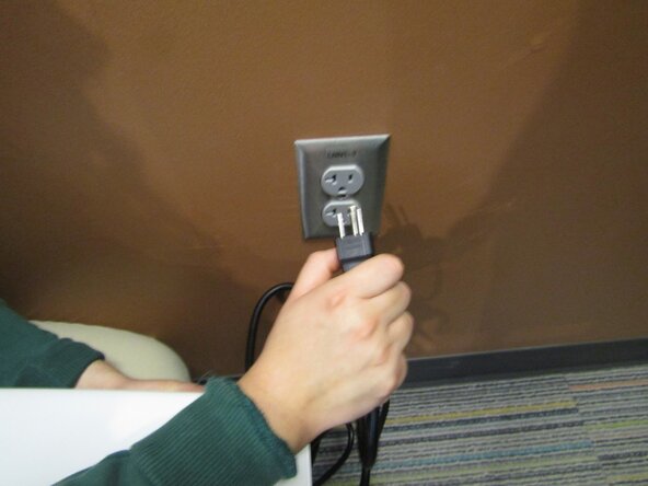

  1. Optoma PRO360W Bulb Replacement, Unplug projector: crwdns2935265:01crwdnd2935265:01crwdnd2935265:01crwdne2935265:0
    • Unplug the projector from the wall outlet to allow for the light bulb to cool for at least 30 minutes.

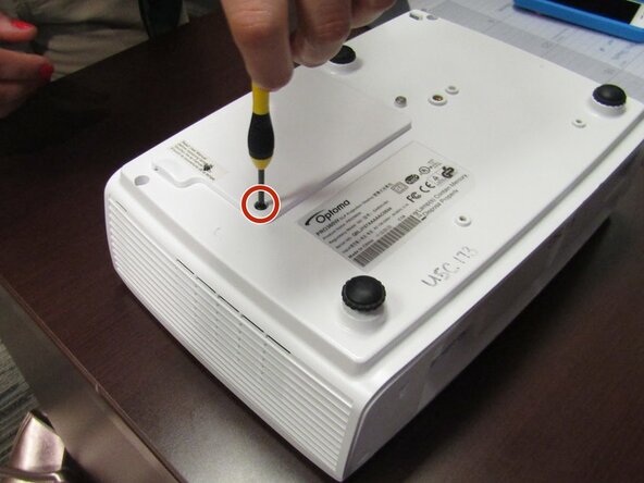

    • On the bottom side of the projector, locate and unscrew the back cover using a Philip's head screwdriver.

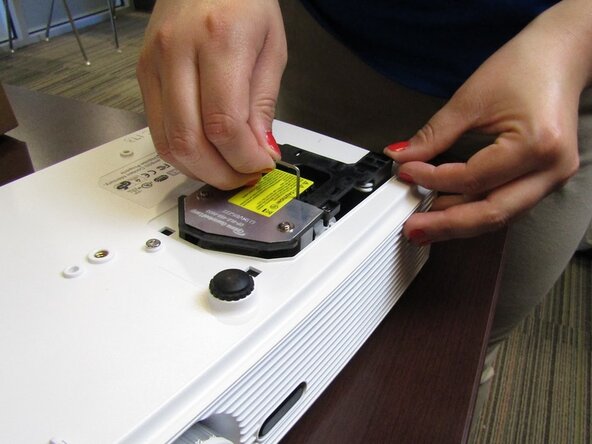

  3. Optoma PRO360W Bulb Replacement: crwdns2935265:03crwdnd2935265:01crwdnd2935265:01crwdne2935265:0

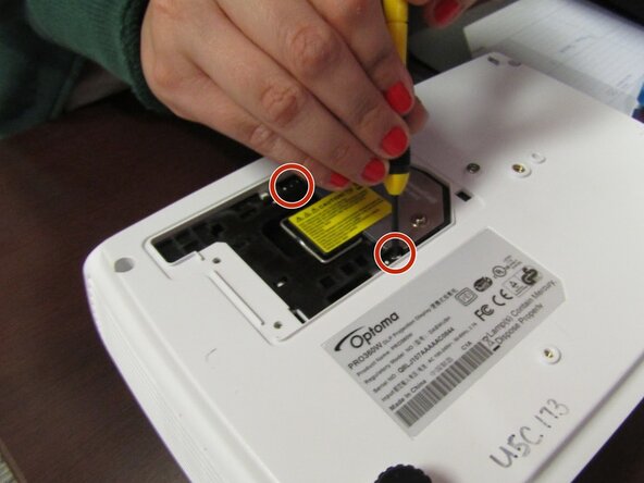

    • Unscrew the bulb screws on either side of the silver plate.
  4. Optoma PRO360W Bulb Replacement: crwdns2935265:04crwdnd2935265:01crwdnd2935265:01crwdne2935265:0

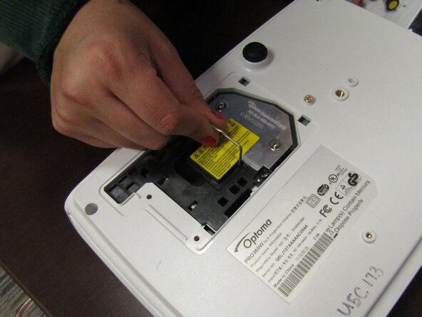

    • Remove the light bulb from the projector by lifting the silver handle and pulling up.
  5. Optoma PRO360W Bulb Replacement: crwdns2935265:05crwdnd2935265:01crwdnd2935265:01crwdne2935265:0

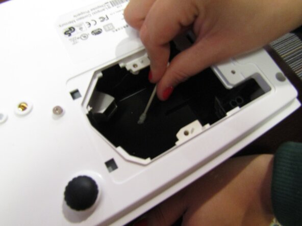

    • Clean the now vacant area where the light bulb once belonged of dust and particles using a Q-tip.
  6. Optoma PRO360W Bulb Replacement: crwdns2935265:06crwdnd2935265:01crwdnd2935265:01crwdne2935265:0

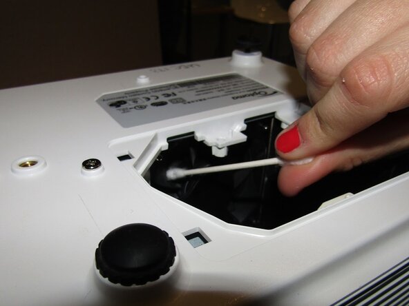

    • Use a new Q-tip to clean the fan blades and hole in which the light enters.
  7. Optoma PRO360W Bulb Replacement: crwdns2935265:07crwdnd2935265:01crwdnd2935265:01crwdne2935265:0

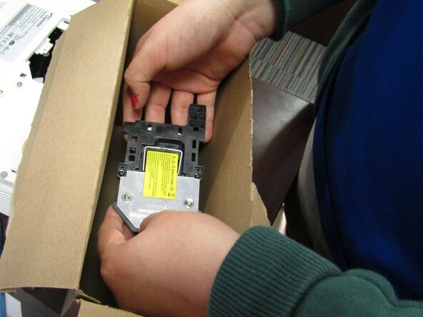

    • Open and remove the new light bulb from its box with clean hands to prevent from getting the bulb dirty.
  8. Optoma PRO360W Bulb Replacement: crwdns2935265:08crwdnd2935265:01crwdnd2935265:01crwdne2935265:0

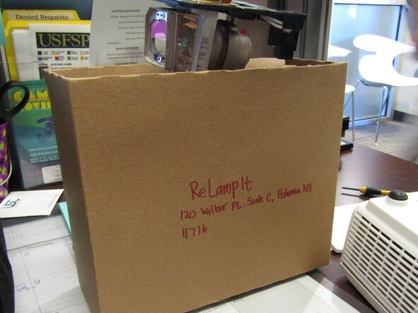

  9. Optoma PRO360W Bulb Replacement: crwdns2935265:09crwdnd2935265:01crwdnd2935265:01crwdne2935265:0
    • Dispose of the bulb by sending it to a recycling center.
