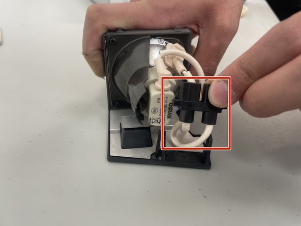

      • Lift the panel off of the device using the metal handle.
      • Disconnect the pink wires from the black plastic housing.

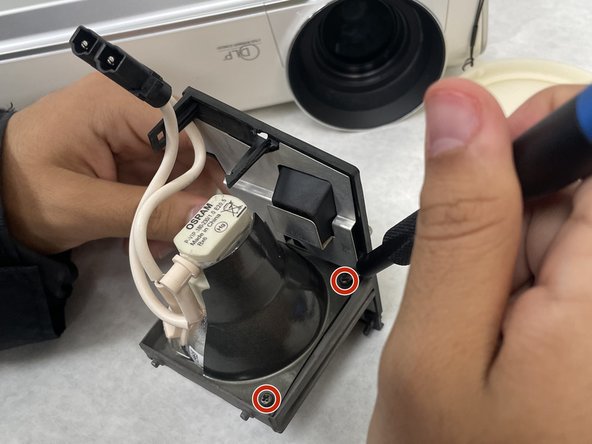

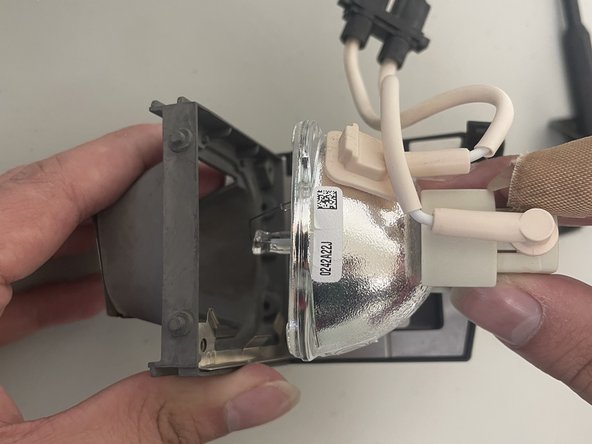

      • Use a Phillips #2 screwdriver to remove the four 2 mm screws that secure the lamp to its housing.
      • Remove the projection lamp casing by gently lifting the bulb from its housing.

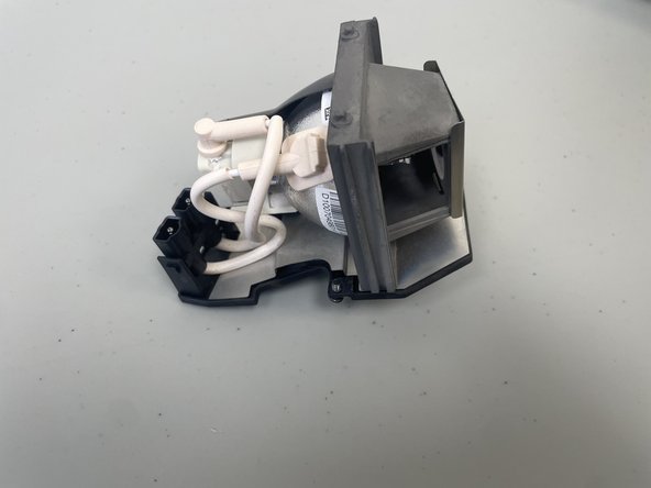

      • Once the bulb is out, replace it with another bulb and re-secure the housings in reverse order to this guide.
      • The second photo is what the completed bulb housing should look like.
