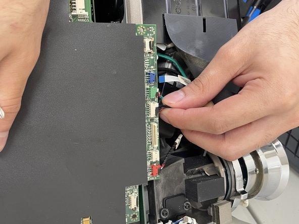

    • Flip the device over and slightly lift the upper case, with care not to strain the two cables.
    • Disconnect the two cables that connect the top case to the motherboard.
    • Lift the upper case up and off.

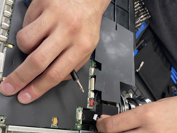

  3. Optoma HD72 Power Supply Replacement, Power Supply: crwdns2935265:03crwdnd2935265:01crwdnd2935265:03crwdne2935265:0 Optoma HD72 Power Supply Replacement, Power Supply: crwdns2935265:03crwdnd2935265:02crwdnd2935265:03crwdne2935265:0 Optoma HD72 Power Supply Replacement, Power Supply: crwdns2935265:03crwdnd2935265:03crwdnd2935265:03crwdne2935265:0
    • Remove the four 2 mm Phillips screws that secure the motherboard.
    • Remove the detachable wire bundles that connect to the ballast supply.

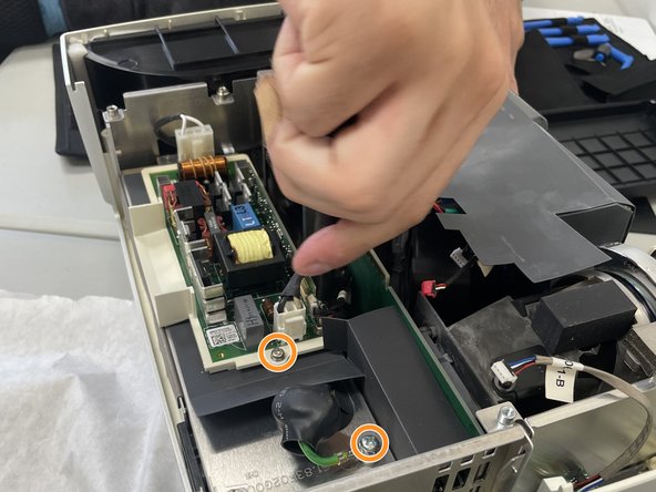

  4. Optoma HD72 Power Supply Replacement: crwdns2935265:04crwdnd2935265:01crwdnd2935265:03crwdne2935265:0 Optoma HD72 Power Supply Replacement: crwdns2935265:04crwdnd2935265:02crwdnd2935265:03crwdne2935265:0 Optoma HD72 Power Supply Replacement: crwdns2935265:04crwdnd2935265:03crwdnd2935265:03crwdne2935265:0
    • Remove the four 2 mm Phillips #2 screws that secure the power supply.

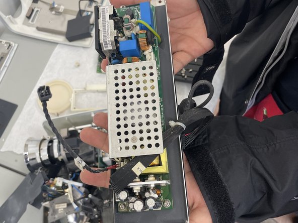

    • Remove the 2 2.0mm Phillips #2 screws that secure the ballast to the power supply using a Phillips #2 screwdriver
    • Disconnect all of the ballast connections.
    • Lift the ballast out of the device.

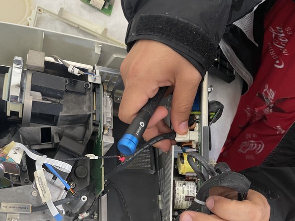

  5. Optoma HD72 Power Supply Replacement: crwdns2935265:05crwdnd2935265:01crwdnd2935265:03crwdne2935265:0 Optoma HD72 Power Supply Replacement: crwdns2935265:05crwdnd2935265:02crwdnd2935265:03crwdne2935265:0 Optoma HD72 Power Supply Replacement: crwdns2935265:05crwdnd2935265:03crwdnd2935265:03crwdne2935265:0

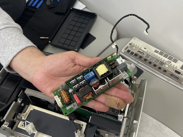

    • Remove the two Phillips screws that secure the power supply.
    • Disconnect the ballast from the power supply.
    • Remove the power supply.
