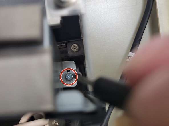

    1. Optoma HD72 Fan Replacement, Upper Case: crwdns2935265:01crwdnd2935265:01crwdnd2935265:02crwdne2935265:0 Optoma HD72 Fan Replacement, Upper Case: crwdns2935265:01crwdnd2935265:02crwdnd2935265:02crwdne2935265:0
      • Use a Phillips screwdriver to remove the five 2 mm screws on the underside of the device.
    2. Optoma HD72 Fan Replacement: crwdns2935265:02crwdnd2935265:01crwdnd2935265:01crwdne2935265:0
      • Flip the device over and slightly lift the upper case, with care not to strain the two cables.
      • Disconnect the two cables that connect the top case to the motherboard.
      • Lift the upper case up and off.

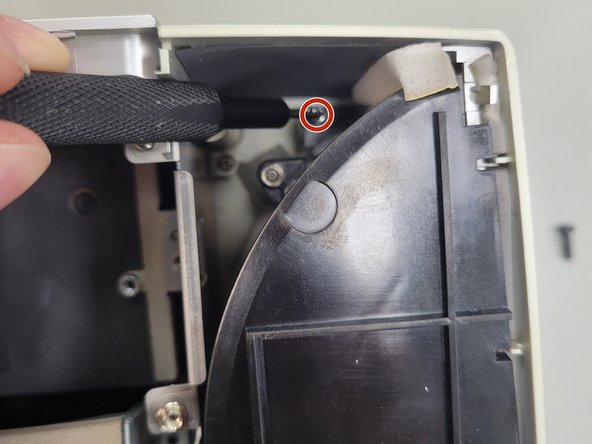

    2. Optoma HD72 Fan Replacement: crwdns2935265:04crwdnd2935265:01crwdnd2935265:01crwdne2935265:0
      • Remove the four 2 mm Phillips screws that secure the motherboard.
      • Lift the motherboard up and out of the chassis.

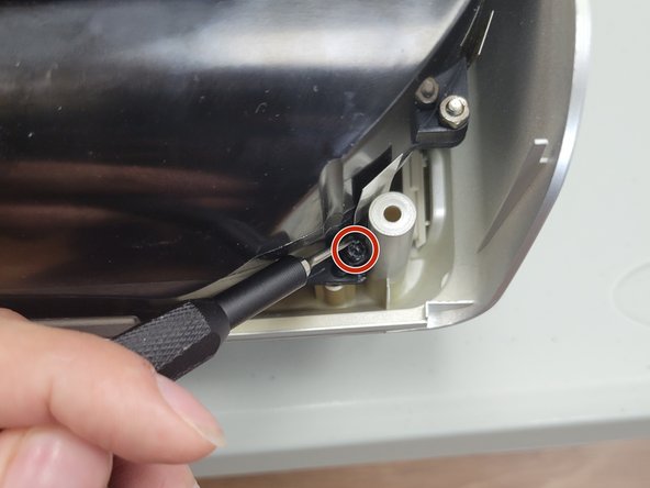

    1. Optoma HD72 Fan Replacement, Fan: crwdns2935265:05crwdnd2935265:01crwdnd2935265:03crwdne2935265:0 Optoma HD72 Fan Replacement, Fan: crwdns2935265:05crwdnd2935265:02crwdnd2935265:03crwdne2935265:0 Optoma HD72 Fan Replacement, Fan: crwdns2935265:05crwdnd2935265:03crwdnd2935265:03crwdne2935265:0
      • Remove the three 2 mm Phillips screws that secure the black housing.
      • Lift the black housing off.

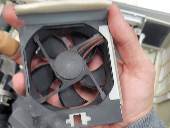

    2. Optoma HD72 Fan Replacement: crwdns2935265:06crwdnd2935265:01crwdnd2935265:03crwdne2935265:0 Optoma HD72 Fan Replacement: crwdns2935265:06crwdnd2935265:02crwdnd2935265:03crwdne2935265:0 Optoma HD72 Fan Replacement: crwdns2935265:06crwdnd2935265:03crwdnd2935265:03crwdne2935265:0
      • Remove the two 2 mm Phillips screws that secure the fan.
      • Lift the fan up and out of the chassis.
