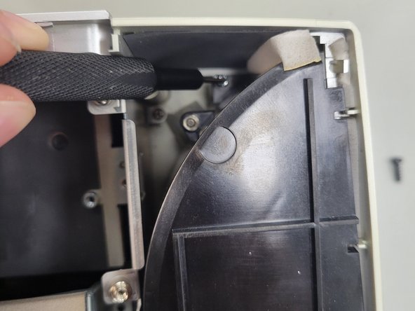

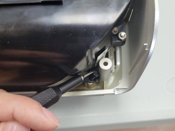

      • Use a Phillips screwdriver to remove the five 2 mm screws on the underside of the device.

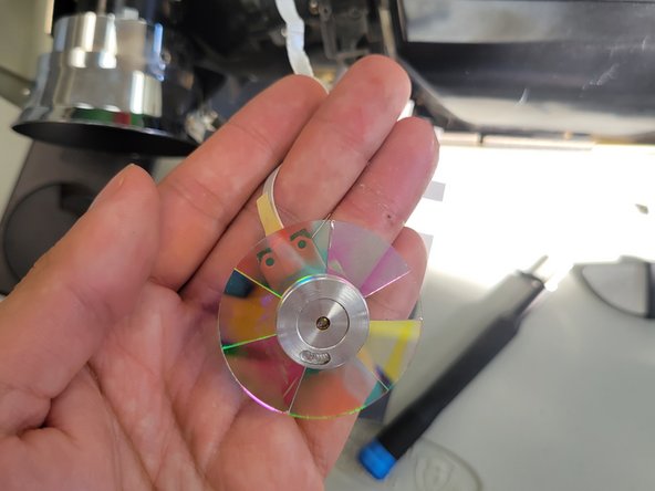

      • Remove the single 2 mm Phillips screw that secures the color wheel.
      • Lift the color wheel up and out of its housing.

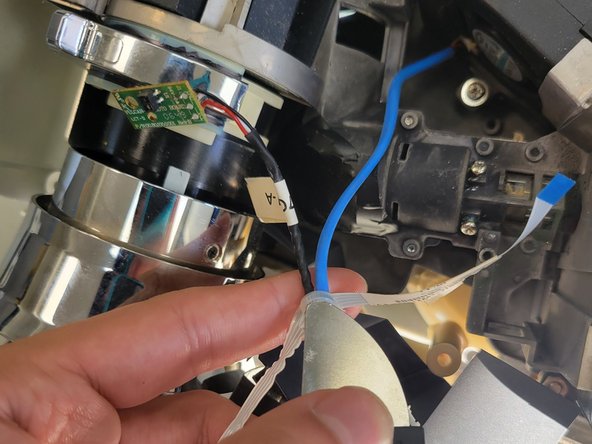

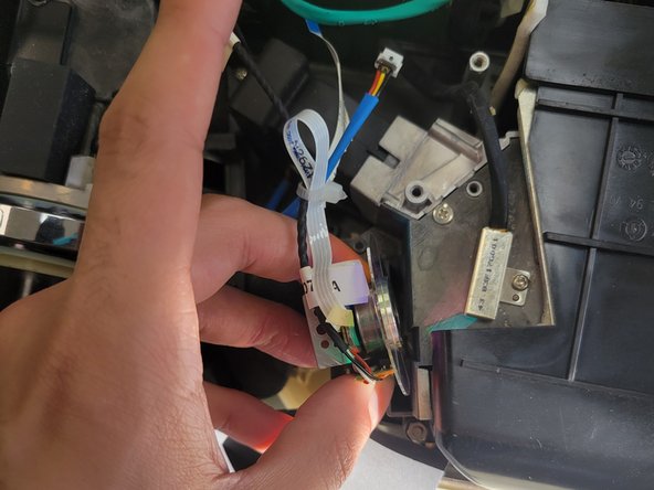

      • Remove the single 2 mm Phillips screw that secures the circuit board to the side of the color wheel.
      • Use a sharp tool to cut the zip tie that secures the color wheel’s cables.
      • Remove the color wheel.
