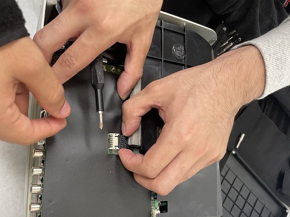

    2. Optoma HD72 Ballast Replacement: crwdns2935265:02crwdnd2935265:01crwdnd2935265:01crwdne2935265:0
      • Flip the device over and slightly lift the upper case, with care not to strain the two cables.
      • Disconnect the two cables that connect the top case to the motherboard.
      • Lift the upper case up and off.

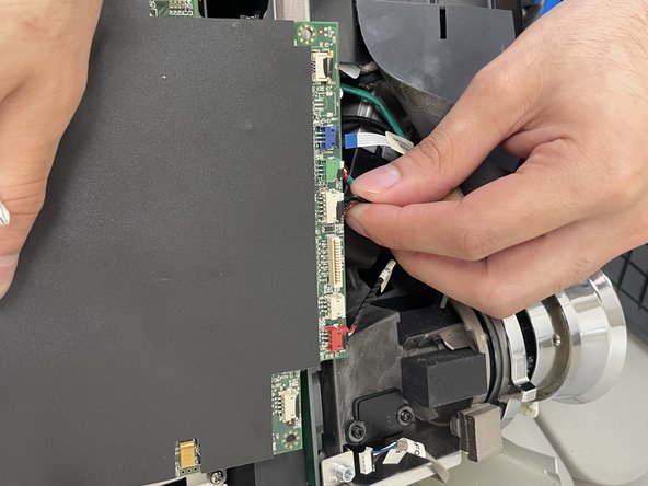

    1. Optoma HD72 Ballast Replacement, Motherboard: crwdns2935265:03crwdnd2935265:01crwdnd2935265:03crwdne2935265:0 Optoma HD72 Ballast Replacement, Motherboard: crwdns2935265:03crwdnd2935265:02crwdnd2935265:03crwdne2935265:0 Optoma HD72 Ballast Replacement, Motherboard: crwdns2935265:03crwdnd2935265:03crwdnd2935265:03crwdne2935265:0
      • Disconnect all of the cables that are connected to the motherboard.
    2. Optoma HD72 Ballast Replacement: crwdns2935265:04crwdnd2935265:01crwdnd2935265:01crwdne2935265:0
      • Remove the four 2 mm Phillips screws that secure the motherboard.
      • Lift the motherboard up and out of the chassis.

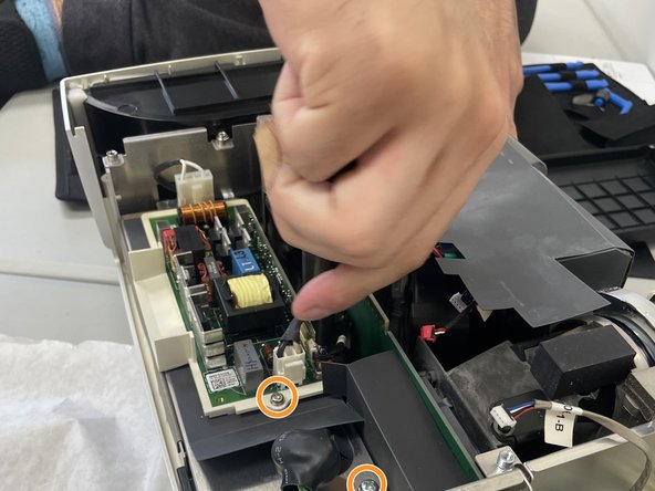

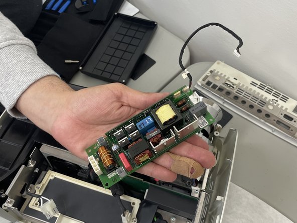

    1. Optoma HD72 Ballast Replacement, Ballast: crwdns2935265:05crwdnd2935265:01crwdnd2935265:03crwdne2935265:0 Optoma HD72 Ballast Replacement, Ballast: crwdns2935265:05crwdnd2935265:02crwdnd2935265:03crwdne2935265:0 Optoma HD72 Ballast Replacement, Ballast: crwdns2935265:05crwdnd2935265:03crwdnd2935265:03crwdne2935265:0
      • Remove the two 2 mm Phillips screws that secure the power supply.
      • Remove the two 2 mm Phillips screws that secure the ballast to the power supply.
      • Disconnect the bundles of detachable wires from the ballast.
      • Lift the ballast out of the device.
