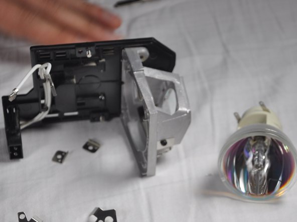

Use this guide to remove the light bulb from your Optoma HD20.
    1. Optoma HD20 Light Bulb Replacement, Rear Panel: crwdns2935265:01crwdnd2935265:01crwdnd2935265:02crwdne2935265:0 Optoma HD20 Light Bulb Replacement, Rear Panel: crwdns2935265:01crwdnd2935265:02crwdnd2935265:02crwdne2935265:0
      • Use a Phillips #1 screwdriver to loosen the screws that secure the panel on the bottom of the Optoma HD20.
    2. Optoma HD20 Light Bulb Replacement: crwdns2935265:02crwdnd2935265:01crwdnd2935265:01crwdne2935265:0
      • Lift the panel off of the device.
    3. Optoma HD20 Light Bulb Replacement, Light Bulb Casing: crwdns2935265:03crwdnd2935265:01crwdnd2935265:01crwdne2935265:0
      • Use a Phillips #1 screwdriver to loosen the two screws securing the black casing.
      • The screws don't come out all the way.
    4. Optoma HD20 Light Bulb Replacement: crwdns2935265:04crwdnd2935265:01crwdnd2935265:03crwdne2935265:0 Optoma HD20 Light Bulb Replacement: crwdns2935265:04crwdnd2935265:02crwdnd2935265:03crwdne2935265:0 Optoma HD20 Light Bulb Replacement: crwdns2935265:04crwdnd2935265:03crwdnd2935265:03crwdne2935265:0
      • Remove the light bulb casing from the device.
      • Steps 5-9 are unnecessary if the replacement light bulb comes with housing.
    5. Optoma HD20 Light Bulb Replacement, Light Bulb: crwdns2935265:05crwdnd2935265:01crwdnd2935265:01crwdne2935265:0
      • Remove the three 4.5 mm screws on the light bulb case.
    6. Optoma HD20 Light Bulb Replacement: crwdns2935265:06crwdnd2935265:01crwdnd2935265:01crwdne2935265:0
      • Carefully remove the light bulb insulator from the light bulb casing.
    7. Optoma HD20 Light Bulb Replacement: crwdns2935265:07crwdnd2935265:01crwdnd2935265:01crwdne2935265:0
      • Gently pull the wires off of the pins using tweezers.
    8. Optoma HD20 Light Bulb Replacement: crwdns2935265:08crwdnd2935265:01crwdnd2935265:01crwdne2935265:0
      • Remove the 4 screws on the back of the light bulb casing using a Phillips #1 screwdriver.
    9. Optoma HD20 Light Bulb Replacement: crwdns2935265:09crwdnd2935265:01crwdnd2935265:02crwdne2935265:0 Optoma HD20 Light Bulb Replacement: crwdns2935265:09crwdnd2935265:02crwdnd2935265:02crwdne2935265:0
      • Remove the casing, then gently pull out the old light bulb and replace it with the new one.
