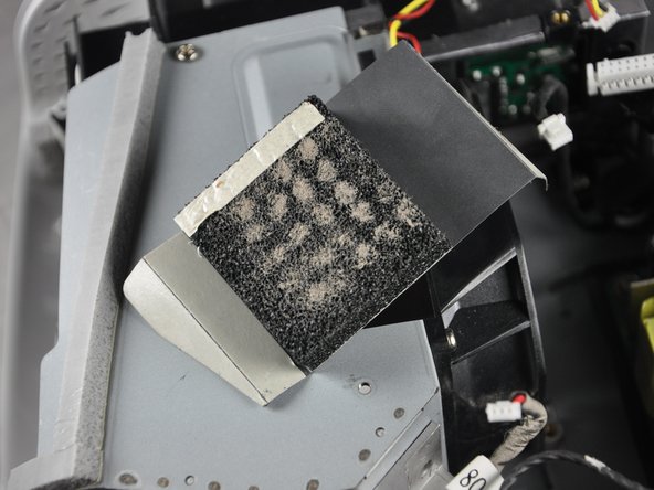

    1. Optoma HD20 Air Filter Replacement, Air Filter: crwdns2935265:05crwdnd2935265:01crwdnd2935265:03crwdne2935265:0 Optoma HD20 Air Filter Replacement, Air Filter: crwdns2935265:05crwdnd2935265:02crwdnd2935265:03crwdne2935265:0 Optoma HD20 Air Filter Replacement, Air Filter: crwdns2935265:05crwdnd2935265:03crwdnd2935265:03crwdne2935265:0
      • Carefully peel off each air filter from the device
      • Pull up on the air filter to remove it.
    2. Optoma HD20 Air Filter Replacement: crwdns2935265:06crwdnd2935265:01crwdnd2935265:01crwdne2935265:0
      • Remove the air filter from the device.
      • Try not to deposit dirt from the air filter into the inside of the device.

There were no filters where the photos indicate.
