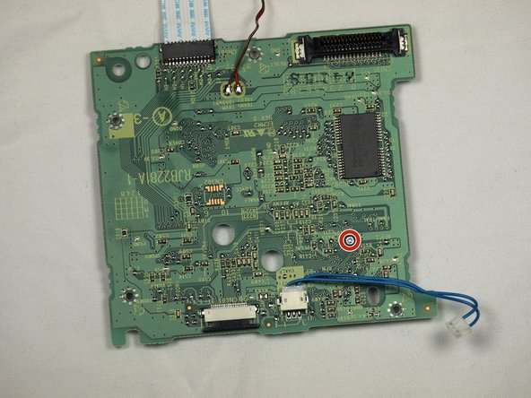

  17. Optical Laser Lens Power Adjustment, Optical Laser Lens Power Adjustment: crwdns2935265:017crwdnd2935265:01crwdnd2935265:02crwdne2935265:0 Optical Laser Lens Power Adjustment, Optical Laser Lens Power Adjustment: crwdns2935265:017crwdnd2935265:02crwdnd2935265:02crwdne2935265:0
    • Rotate the assembly so that the green circuit board is facing you as shown in the first picture.
    • Flip board over so it is oriented as shown in the second picture.
    • Using a Phillips #1 Screwdriver, turn the small knob very slightly counter-clockwise—a few degrees to, at most, one-quarter turn.
    • You can find instructions for testing to make sure your repair worked at this link.

I don't understand why you have steps 11-17. In step 10, you can clearly see the board with the screw that needs adjusting. Taking apart the rest of the GameCube is utterly unnecessary. After following the guide in full, I thought, 'Why did I just dismantle all that other stuff when I didn't even NEED to?'
Once the assembly is removed from the metal covering the board, it is a simple matter to turn the screw to increase the laser strength. I did this after my initial adjustment didn't work. I ignored steps 11-17 and everything works perfectly now. My old games which simply would not load, now do. Thanks for the advice leading up to step 10 though. That part was helpful.

I wouldn't say it's a quarter of a turn, a few degrees clockwise do the trick. I tried a quarter of a turn the first time and it made the disk unit useless as it didn't recognise any gamecube disk.

Thanks for the detailed pictures! I was able to get everything taken apart, and fixed the read error I was having after a couple of readjustments.
One important note: the lens screw should be turned counter-clockwise, not clockwise. A quarter turn is also likely to be too much; better to adjust a few degrees at a time and test repeatedly until the right setting is found.
gameFAQs.com has a lens calibration guide, with notes on how to reassemble the GameCube for testing without screwing everything back together.
I also agree that steps 11-17 can be skipped, as well as step 5 to remove the controller ports.

Steps 11+ are definitely not needed and 1/4 turn is more than 200ohms, way too much. It has to be moved by a hair (almost literally), the potentiometer is extremely sensitive. And I would personally recommend some form of multimeter, as to not go turning that screw blindly.
