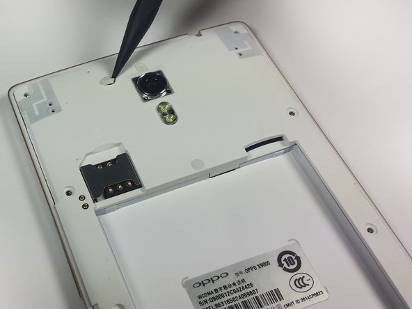

    2. Oppo X9000 Volume Button Replacement, Remove the Rubber Stoppers: crwdns2935265:04crwdnd2935265:01crwdnd2935265:02crwdne2935265:0 Oppo X9000 Volume Button Replacement, Remove the Rubber Stoppers: crwdns2935265:04crwdnd2935265:02crwdnd2935265:02crwdne2935265:0
      • Remove the three circular rubber screw covers on the back of the phone by slipping the spudger into the border between the rubber cover and the chassis. In one motion, pry the stopper out of the hole. This can take some force.

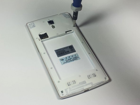

    3. Oppo X9000 Volume Button Replacement, Remove the Newly Exposed Screws: crwdns2935265:05crwdnd2935265:01crwdnd2935265:01crwdne2935265:0
      • With the 3.6 mm Phillips screwdriver, remove the three newly exposed 3.6mm Phillips screws.

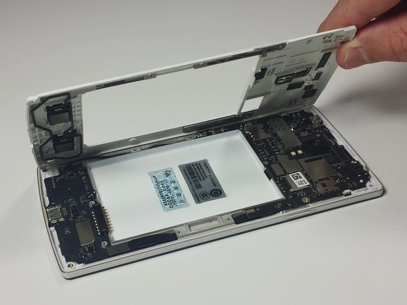

    4. Oppo X9000 Volume Button Replacement, Lift off the Back Panel: crwdns2935265:06crwdnd2935265:01crwdnd2935265:02crwdne2935265:0 Oppo X9000 Volume Button Replacement, Lift off the Back Panel: crwdns2935265:06crwdnd2935265:02crwdnd2935265:02crwdne2935265:0
      • Insert the plastic opening tool underneath the chassis near the power button and pry the chassis from the phone. This should take a little force.
