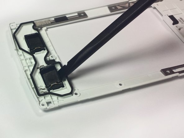

  7. Oppo X9000 Speaker Drivers Replacement, Remove the Speaker Drivers: crwdns2935265:07crwdnd2935265:01crwdnd2935265:02crwdne2935265:0 Oppo X9000 Speaker Drivers Replacement, Remove the Speaker Drivers: crwdns2935265:07crwdnd2935265:02crwdnd2935265:02crwdne2935265:0
    • Using the flat end of the spudger, pry the speaker drivers off of the chassis.
