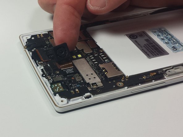

  7. Oppo X9000 Rear Camera Replacement, Rear Camera: crwdns2935265:07crwdnd2935265:01crwdnd2935265:02crwdne2935265:0 Oppo X9000 Rear Camera Replacement, Rear Camera: crwdns2935265:07crwdnd2935265:02crwdnd2935265:02crwdne2935265:0
    • Use your fingers to pull the camera straight up from the motherboard to fully detach the camera.
