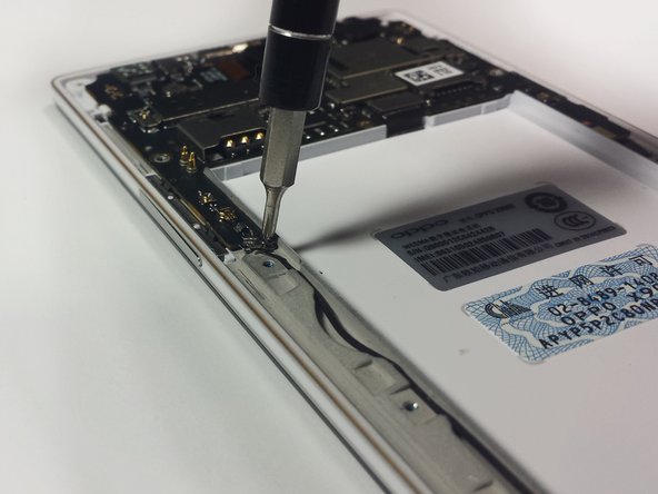

  11. Oppo X9000 Earpiece Speaker Replacement, Remove the Black Screws: crwdns2935265:011crwdnd2935265:01crwdnd2935265:02crwdne2935265:0 Oppo X9000 Earpiece Speaker Replacement, Remove the Black Screws: crwdns2935265:011crwdnd2935265:02crwdnd2935265:02crwdne2935265:0
    • The motherboard is split into two different chips. The large chip is located above where the battery rests and the smaller chip is located below it.
    • Remove the three 3.6 mm Phillip's screws on the motherboard.
    • A small silver piece of metal is connected to the lowest screw and may fall off. This metal holds the WiFi antenna in place and should not be lost; although the phone operates just fine without it.

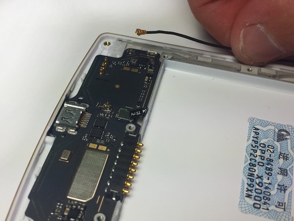

  15. Oppo X9000 Earpiece Speaker Replacement, Disconnect the WiFi Antenna: crwdns2935265:015crwdnd2935265:01crwdnd2935265:02crwdne2935265:0 Oppo X9000 Earpiece Speaker Replacement, Disconnect the WiFi Antenna: crwdns2935265:015crwdnd2935265:02crwdnd2935265:02crwdne2935265:0
    • With your fingers, gently pull upwards on the WiFi antenna near the connection on the smaller motherboard until the antenna is no longer connected to the bottom motherboard.

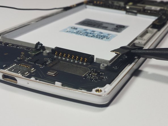

  16. Oppo X9000 Earpiece Speaker Replacement, Remove the Small Motherboard: crwdns2935265:016crwdnd2935265:01crwdnd2935265:01crwdne2935265:0
    • Use the spudger to carefully pry the small motherboard off of the phone.
    • Start from the sides of the lower motherboard closest to the charging port. Carefully pry the motherboard off until it is no longer connected to the phone.

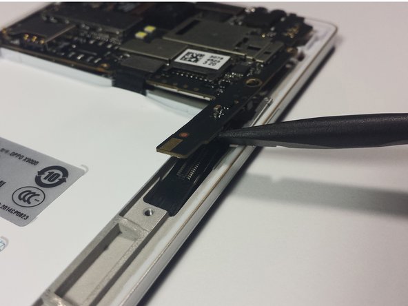

  17. Oppo X9000 Earpiece Speaker Replacement, Remove the Big Motherboard: crwdns2935265:017crwdnd2935265:01crwdnd2935265:01crwdne2935265:0
    • Use the spudger to carefully pry the bigger motherboard off of the phone.
    • Start from the top of the large motherboard. Carefully pry the motherboard off until it is no longer connected to the phone.

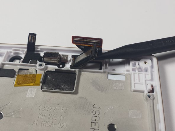

  18. Oppo X9000 Earpiece Speaker Replacement, Remove the Earpiece Speaker: crwdns2935265:018crwdnd2935265:01crwdnd2935265:02crwdne2935265:0 Oppo X9000 Earpiece Speaker Replacement, Remove the Earpiece Speaker: crwdns2935265:018crwdnd2935265:02crwdnd2935265:02crwdne2935265:0
    • Use the spudger to pry the earpiece speaker out of the phone.
    • The earpiece speaker has a rubber lining. If the rubber lining falls off of the earpiece speaker, simply place it back on the earpiece speaker.
