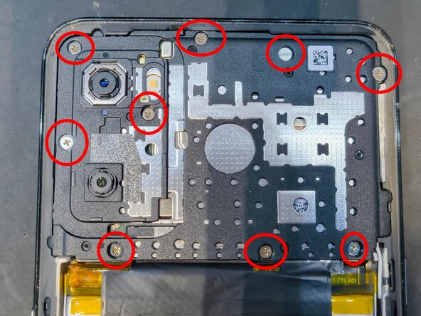

  1. Oppo A55s Screen Replacement, Remove main board cover screws: crwdns2935265:02crwdnd2935265:01crwdnd2935265:01crwdne2935265:0
    • 9 Philips head screws cover the main board cover. Remove these and gently remove the main board cover to expose the board connections.
