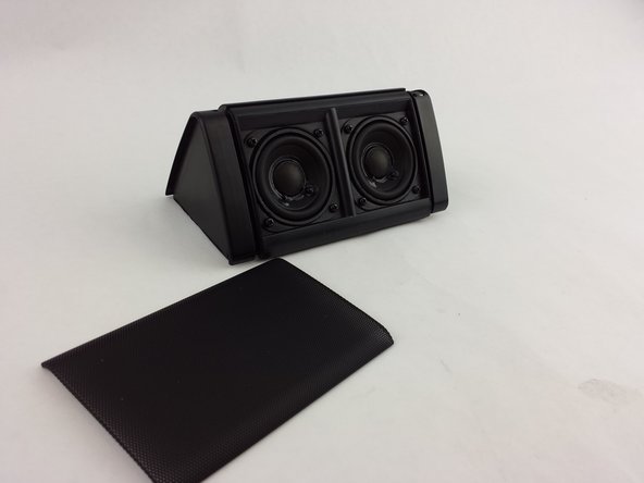

  4. OontZ Angle 3 Speaker Replacement, Speaker: crwdns2935265:04crwdnd2935265:01crwdnd2935265:02crwdne2935265:0 OontZ Angle 3 Speaker Replacement, Speaker: crwdns2935265:04crwdnd2935265:02crwdnd2935265:02crwdne2935265:0
    • Use the plastic opening tool to remove the front speaker plate from the speaker.
  5. OontZ Angle 3 Speaker Replacement: crwdns2935265:05crwdnd2935265:01crwdnd2935265:02crwdne2935265:0 OontZ Angle 3 Speaker Replacement: crwdns2935265:05crwdnd2935265:02crwdnd2935265:02crwdne2935265:0
    • Remove the eight (8) 5.25mm screws with the Phillips #0 screwdriver.
    • Open access to the speakers by letting them rest as shown.

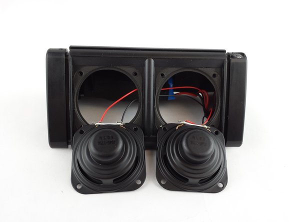

  6. OontZ Angle 3 Speaker Replacement: crwdns2935265:06crwdnd2935265:01crwdnd2935265:02crwdne2935265:0 OontZ Angle 3 Speaker Replacement: crwdns2935265:06crwdnd2935265:02crwdnd2935265:02crwdne2935265:0
    • Use the soldering iron to carefully disconnect the speaker(s) from the motherboard connection wires.
    • Learn more about soldering here.
    • Remove the disconnected speaker(s).
    • When reconnecting the wires to the new speaker(s), be careful to connect the wires to the correct nodes (red for positive and black for negative). If they are reconnected to the wrong locations the speakers will either not work or break.

same question, I am looking for original speaker for oontz angle 3 and I can’t find one. Those who are looking for the size, its 40x40mm (1.57”) 4ohms 3W
