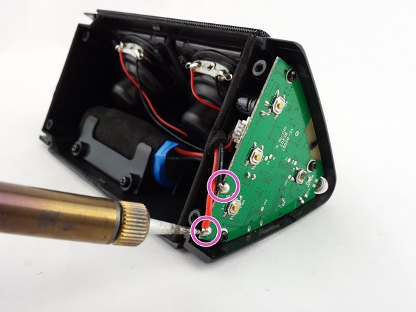

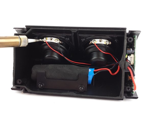

    • Locate the soldering connections for the battery on the motherboard and the wires for the speakers.
    • Use the soldering iron to disconnect the battery wires from the motherboard.
    • Use the soldering iron to disconnect the speaker wires from the motherboard.
    • When reconnecting the battery and speakers to the new motherboard, be careful to make the connections to the correct nodes as well as establish a complete connection, as the speakers could break with an incorrect connection and the battery risks overheating or erupting in flames if corrected incorrectly or poorly.

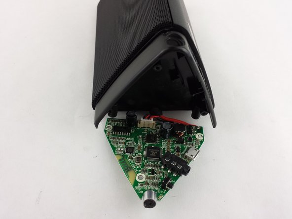

  5. OontZ Angle 3 Motherboard Replacement: crwdns2935265:05crwdnd2935265:01crwdnd2935265:03crwdne2935265:0 OontZ Angle 3 Motherboard Replacement: crwdns2935265:05crwdnd2935265:02crwdnd2935265:03crwdne2935265:0 OontZ Angle 3 Motherboard Replacement: crwdns2935265:05crwdnd2935265:03crwdnd2935265:03crwdne2935265:0

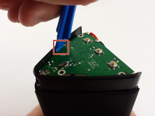

    • Remove the three (3) 3.6mm screws using a Phillips #0 screwdriver.
    • Use the plastic opening tool about midway down one side of the motherboard to pry it out of the casing.
    • Remove the faulty motherboard.
