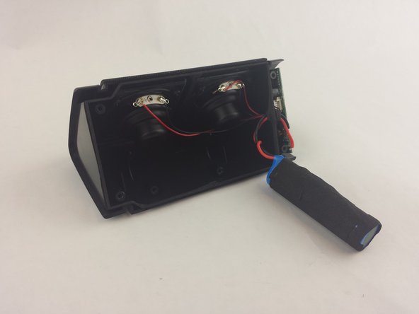

    1. OontZ Angle 3 Battery Replacement, Battery: crwdns2935265:04crwdnd2935265:01crwdnd2935265:03crwdne2935265:0 OontZ Angle 3 Battery Replacement, Battery: crwdns2935265:04crwdnd2935265:02crwdnd2935265:03crwdne2935265:0 OontZ Angle 3 Battery Replacement, Battery: crwdns2935265:04crwdnd2935265:03crwdnd2935265:03crwdne2935265:0
      • Begin by removing the bottom piece, revealing the inner compartment with the speaker cables and battery.
      • Remove two (2) 11.7mm Phillips #0 screws from each side of the speaker plate.
      • Remove speaker plate from the front of the battery.

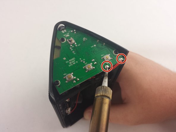

    2. OontZ Angle 3 Battery Replacement: crwdns2935265:05crwdnd2935265:01crwdnd2935265:03crwdne2935265:0 OontZ Angle 3 Battery Replacement: crwdns2935265:05crwdnd2935265:02crwdnd2935265:03crwdne2935265:0 OontZ Angle 3 Battery Replacement: crwdns2935265:05crwdnd2935265:03crwdnd2935265:03crwdne2935265:0
      • Locate the soldering points for the battery on the motherboard face of the speaker.
      • Use a soldering iron to carefully disconnect the battery from the motherboard.
      • Learn more about soldering here.
      • Remove the battery from the inside compartment for replacement.
      • Be careful when soldering the new battery into the correct position on the motherboard, as a bad connection can cause the battery to overheat or catch on fire.

What is the kind of battery used? Thanks!
Rodrigo Lopez - crwdns2934203:0crwdne2934203:0 crwdns2950251:0crwdne2950251:0
Hi Rodrigo, the Oontz Angle 3 uses a rechargeable 2200mAh lithium-ion battery. Happy Fixing!
Kelsea Weber - crwdns2934203:0crwdne2934203:0 crwdns2950251:0crwdne2950251:0
the one that I have has a "circuit board" attached to the battery. Is this what controls the recharging? If so, where do you get the battery with these?
Rob - crwdns2934203:0crwdne2934203:0 crwdns2950251:0crwdne2950251:0
Hi Rob,use soldering iron disconnect the circuit board which come with old battery you going to replace, and soldering iron the disconnected circuit board back onto your new battery. The so called circuit board is to protect the battery from over discharge or over charge. Hope this help.
