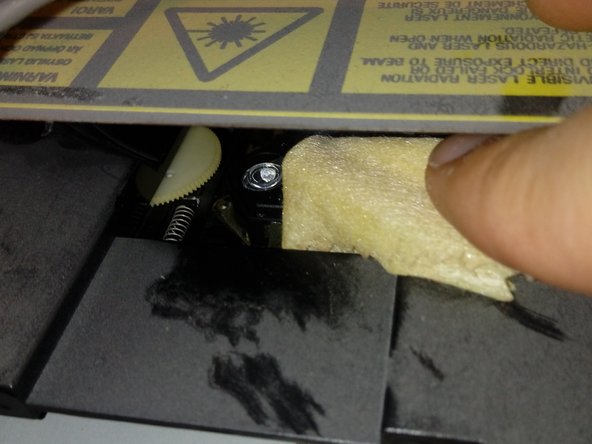

    • The laser is located under the laser protection shield
    • You can move it closer by turning the white gear to get better access to clean it

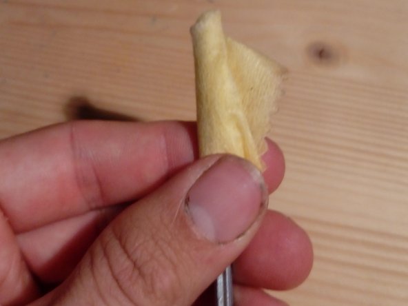

    • Take a microfiber cloth or any clean cloth which is lint-free
    • Wrap it around a flat screwdriver and soak it with high-percentage cleaning alcohol. I used 80% alcohol and it worked fine
    • Clean gently and carefully the lense
    • Turn the laser back to its standard position with the gearwheel
