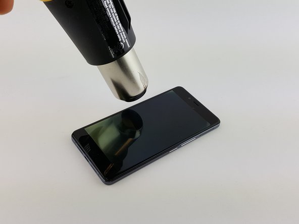

    1. OnePlus X Screen Replacement, Screen: crwdns2935265:08crwdnd2935265:01crwdnd2935265:03crwdne2935265:0 OnePlus X Screen Replacement, Screen: crwdns2935265:08crwdnd2935265:02crwdnd2935265:03crwdne2935265:0 OnePlus X Screen Replacement, Screen: crwdns2935265:08crwdnd2935265:03crwdnd2935265:03crwdne2935265:0
      • Once all of the components on the back of the phone have been removed (battery, SIM card, etc), prepare for a battle with your heat gun and "oven mitts".
      • This repair is an end-of-the-line option. Please keep in mind that replacing this screen will most likely damage, crack, or discolour the screen, so it is advised to only do this as a last resort. This should be done at your own risk.
      • Using your heat resistant glove to hold onto the phone, evenly heat the edges of the phone.
      • Spend about 15-20 seconds on a small section about 2 inches long to make sure that it is sufficiently hot to remove the adhesive

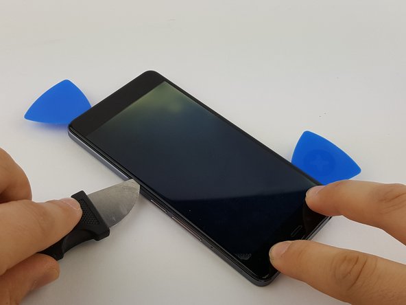

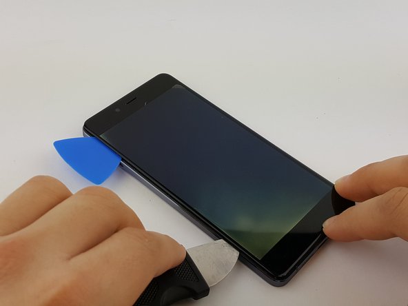

    2. OnePlus X Screen Replacement, Removing the screen: crwdns2935265:09crwdnd2935265:01crwdnd2935265:03crwdne2935265:0 OnePlus X Screen Replacement, Removing the screen: crwdns2935265:09crwdnd2935265:02crwdnd2935265:03crwdne2935265:0 OnePlus X Screen Replacement, Removing the screen: crwdns2935265:09crwdnd2935265:03crwdnd2935265:03crwdne2935265:0
      • After sufficiently heating a section of the edge, use the jimmy tool and slide it between the glass screen and the aluminum bezel of the phone.
      • Proceed to gently slide the jimmy around the area that has been heated to remove the the screen from the adhesive.
      • Having heat resistant gloves are very important as the device will get very hot and will burn your fingers if you come into contact directly with the phone.
      • It might be helpful to use the picks to leave in between the glass and bezel so that the adhesive does not reattach.
      • Continue to follow Steps 1-2 through the perimeter of the phone to remove the adhesive.

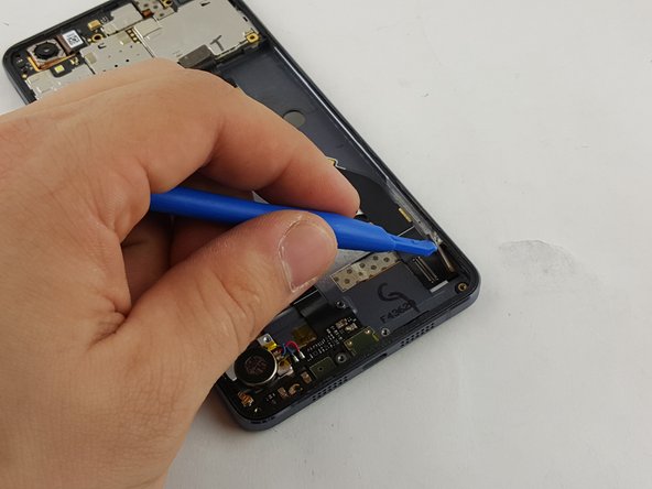

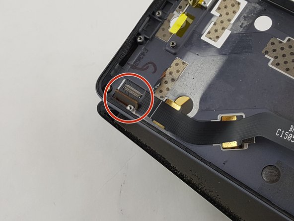

    3. OnePlus X Screen Replacement: crwdns2935265:010crwdnd2935265:01crwdnd2935265:03crwdne2935265:0 OnePlus X Screen Replacement: crwdns2935265:010crwdnd2935265:02crwdnd2935265:03crwdne2935265:0 OnePlus X Screen Replacement: crwdns2935265:010crwdnd2935265:03crwdnd2935265:03crwdne2935265:0
      • After removing the adhesive and the screen is now loose from the phone, you'll notice that it is still attached to the back through a connector.
      • On the back of the phone, unclip the connector to the screen located on the bottom right hand side of the phone using a plastic pry tool.
      • Now that the pin is disconnected, you will have to gently slip the connector through the hole in the back of the phone to free the entire screen.
      • Once the connector is slipped through the hole, the screen should be free from the phone for good.
