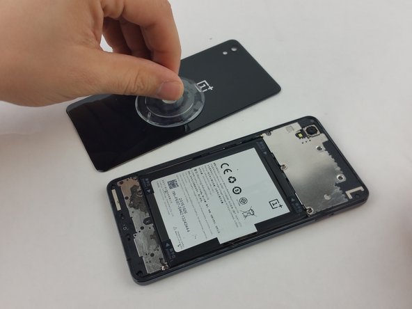

  3. OnePlus X Charging Port Replacement: crwdns2935265:03crwdnd2935265:01crwdnd2935265:03crwdne2935265:0 OnePlus X Charging Port Replacement: crwdns2935265:03crwdnd2935265:02crwdnd2935265:03crwdne2935265:0 OnePlus X Charging Port Replacement: crwdns2935265:03crwdnd2935265:03crwdnd2935265:03crwdne2935265:0
    • Put on heat-resistant gloves and place the phone on a surface that will not catch fire or melt.
    • Using a heat gun, apply slow and even heat to the edges of the back panel.
    • DO NOT stay on one spot for too long, the heat gun can damage the phone if the heat is applied to the same area for a long period of time.
    • While heating the back panel, use a Jimmy to test if the adhesive is soft enough to allow the panel to separate from the device.
    • Carefully detach the back panel, using opening picks to hold the panel apart from the device.
    • Once most of the edges are separated from the device, attach a suction cup to the back panel.
  4. OnePlus X Charging Port Replacement: crwdns2935265:04crwdnd2935265:01crwdnd2935265:03crwdne2935265:0 OnePlus X Charging Port Replacement: crwdns2935265:04crwdnd2935265:02crwdnd2935265:03crwdne2935265:0 OnePlus X Charging Port Replacement: crwdns2935265:04crwdnd2935265:03crwdnd2935265:03crwdne2935265:0
    • Press the suction cup to the back panel to secure it.
    • With the help of the suction cup, pull up on the panel to completely detach it from the device.
    • Use the suction cup to safely remove the panel from the device. As you work around the panel's edges, the lingering heat may cause the remaining adhesive to reattach the panel to the device, be sure to lift the back panel before the glue has time to set back.

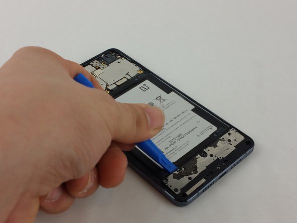

    • On the battery, locate a clear tab. This will be used to pull the battery out.
    • Firmly grasp the clear tab and pull up and away from the phone to remove the battery.
    • Take your time during this step, as you do not want to apply too much force and damage the battery.
    • There is an adhesive underneath the battery so it might be useful to utilize the black plastic spudger to get between the battery and the phone to pry the battery up but be very careful not to break the ribbon cables underneath the battery.
    • Continue to pull slowly on the battery, until it is completely free from the phone.

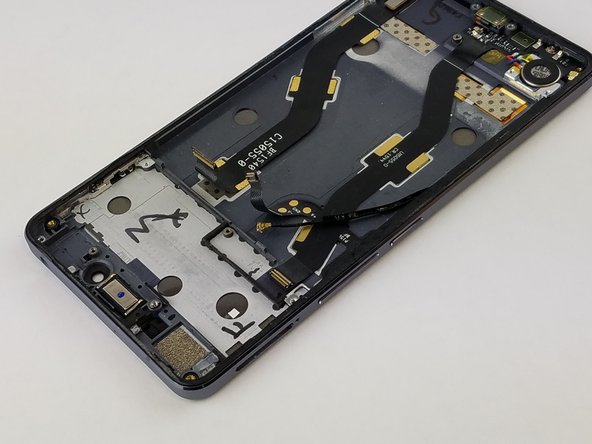

  11. OnePlus X Charging Port Replacement: crwdns2935265:011crwdnd2935265:01crwdnd2935265:03crwdne2935265:0 OnePlus X Charging Port Replacement: crwdns2935265:011crwdnd2935265:02crwdnd2935265:03crwdne2935265:0 OnePlus X Charging Port Replacement: crwdns2935265:011crwdnd2935265:03crwdnd2935265:03crwdne2935265:0
    • After removing the Phillips head screw, you will need to remove a black wire. Use a spudger to unclip the cable first.
    • It might be helpful to bend the cable out of the way when working on the phone.
    • Pull back on the ribbon-cable as shown in the image. This is connected to both the charging port and the vibration module (which is similar to a small watch battery).
    • Gently pry the vibration module out with a plastic opening tool. Be gentle, for it is adhered to the phone.
    • You will need to remove the vibration module before the charging port.
  12. OnePlus X Charging Port Replacement: crwdns2935265:012crwdnd2935265:01crwdnd2935265:03crwdne2935265:0 OnePlus X Charging Port Replacement: crwdns2935265:012crwdnd2935265:02crwdnd2935265:03crwdne2935265:0 OnePlus X Charging Port Replacement: crwdns2935265:012crwdnd2935265:03crwdnd2935265:03crwdne2935265:0
    • Once the vibration module is out, pull up carefully on the cable as the charging port is attached with adhesive.
    • After carefully pulling the port and vibration module, it should now be free from the phone and can be replaced.
