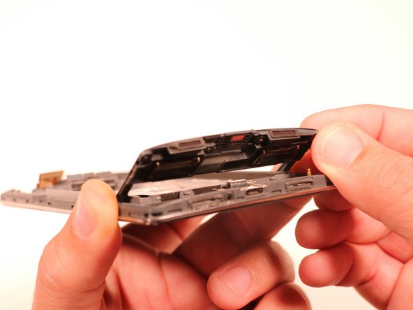

    1. OnePlus One Micro USB Port Replacement, Removing the Lower Back Panel Assembly: crwdns2935265:06crwdnd2935265:01crwdnd2935265:03crwdne2935265:0 OnePlus One Micro USB Port Replacement, Removing the Lower Back Panel Assembly: crwdns2935265:06crwdnd2935265:02crwdnd2935265:03crwdne2935265:0 OnePlus One Micro USB Port Replacement, Removing the Lower Back Panel Assembly: crwdns2935265:06crwdnd2935265:03crwdnd2935265:03crwdne2935265:0
      • Once the battery has been removed, we shift our attention to the back panel assembly. This piece is held together by six screws. See info note below.
      • Luckily, the OnePlus One was assembled with all of the same size screws save for the one holding down the motherboard. All of these screws are philips 00 and 3.175 mm. in lenght.
      • Using the spudger we pry open the panel assembly and, behold, we have access to the micro usb port. You can also use a blue opening tool if you prefer.
      • Keep in mind that there are two hidden screws. Both are located beneath plastic plugs. Tweezers are an effective tool for removing the plugs.

      • Now that we have access to the usb port, we use the flat end of or spudger and lift it off of its connector and free it from the daughterboard.

For me USB was not charging because it seems that one of the 2 USB plugs above the battery were loose. I did replace the battery already sometime far in the past so this might have been the cause. If you just want to re-plug on the upper side and lift the port on the lower side, you don't even need to remove the battery. Just make sure that all plugs, not just USB, are tight before screwing everything back together.
