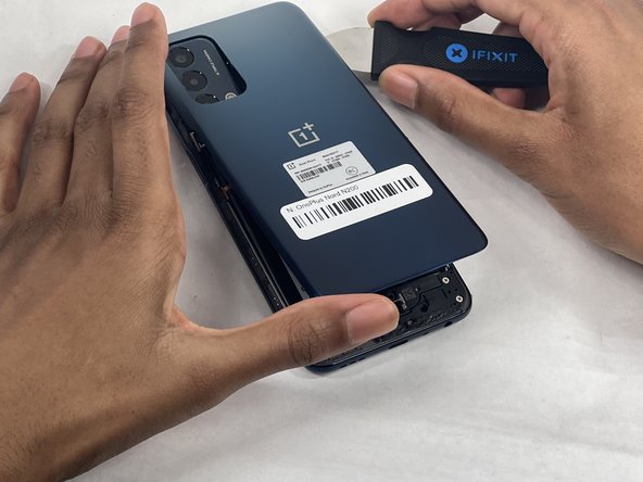

    • Due to its surface, the suction tool won't hold onto the phone's rear glass. A thin slicing tool is required.
    • Insert the Jimmy into the seam between the rear glass and the midframe at the bottom edge of the phone to create a gap.
    • This may require some force.
    • Leave the Jimmy in place for a few seconds to prevent the adhesive from resealing.

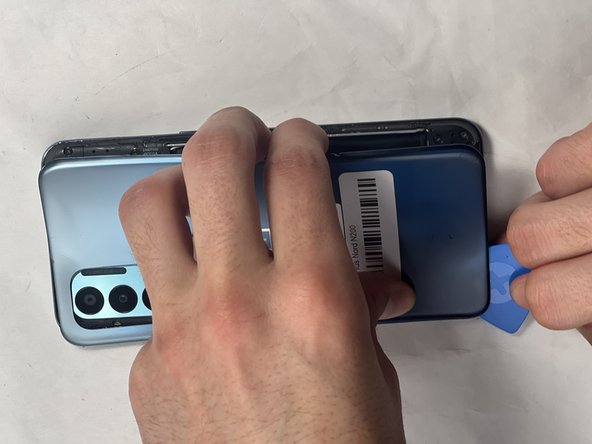

  2. OnePlus Nord N200 Back Cover Replacement: crwdns2935265:02crwdnd2935265:01crwdnd2935265:03crwdne2935265:0 OnePlus Nord N200 Back Cover Replacement: crwdns2935265:02crwdnd2935265:02crwdnd2935265:03crwdne2935265:0 OnePlus Nord N200 Back Cover Replacement: crwdns2935265:02crwdnd2935265:03crwdnd2935265:03crwdne2935265:0
    • Insert an iFixit opening pick into the gap you created with the Jimmy.
    • Slide the Jimmy around the phone to slice the adhesive.
    • Insert a second iFixit opening pick at the spot you have sliced open to keep it open.

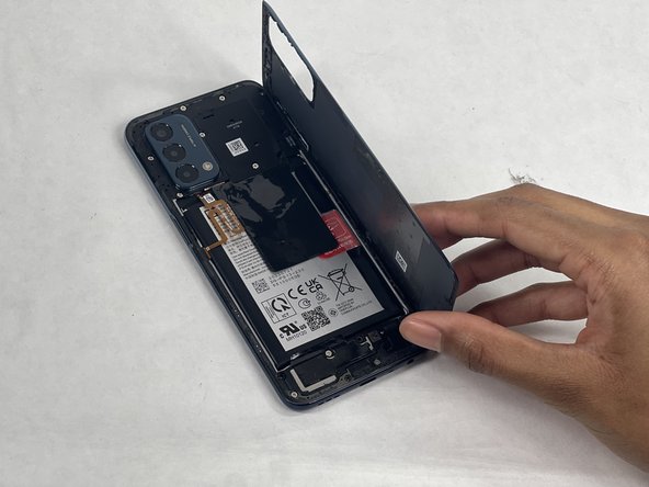

  3. OnePlus Nord N200 Back Cover Replacement: crwdns2935265:03crwdnd2935265:01crwdnd2935265:03crwdne2935265:0 OnePlus Nord N200 Back Cover Replacement: crwdns2935265:03crwdnd2935265:02crwdnd2935265:03crwdne2935265:0 OnePlus Nord N200 Back Cover Replacement: crwdns2935265:03crwdnd2935265:03crwdnd2935265:03crwdne2935265:0
    • Slide the iFixit opening pick along the top edge to slice the adhesive.
    • Start prying the back plate off the phone.

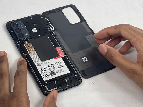

  4. OnePlus Nord N200 Back Cover Replacement: crwdns2935265:04crwdnd2935265:01crwdnd2935265:03crwdne2935265:0 OnePlus Nord N200 Back Cover Replacement: crwdns2935265:04crwdnd2935265:02crwdnd2935265:03crwdne2935265:0 OnePlus Nord N200 Back Cover Replacement: crwdns2935265:04crwdnd2935265:03crwdnd2935265:03crwdne2935265:0
    • Remove the back cover.
