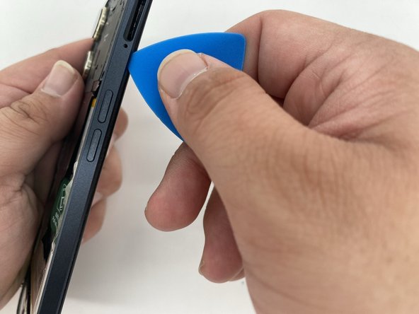

  4. OnePlus Nord N20 5G Screen Replacement: crwdns2935265:04crwdnd2935265:01crwdnd2935265:02crwdne2935265:0 OnePlus Nord N20 5G Screen Replacement: crwdns2935265:04crwdnd2935265:02crwdnd2935265:02crwdne2935265:0
    • Take the iFixit opening tool and run it along the edges.
    • Separate the back housing from the frame of the screen.

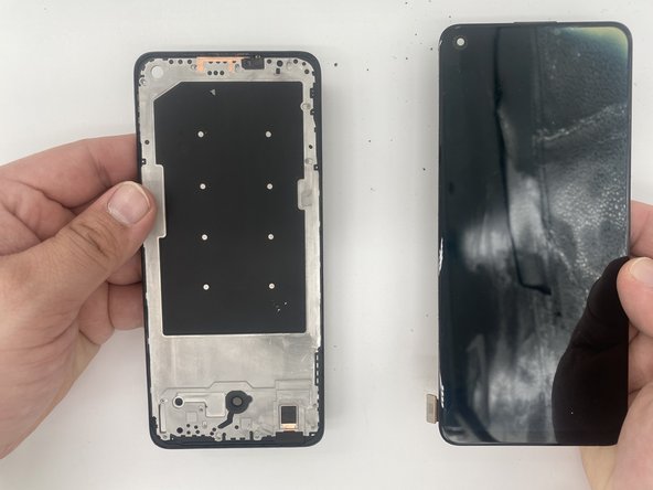

  9. OnePlus Nord N20 5G Screen Replacement: crwdns2935265:09crwdnd2935265:01crwdnd2935265:01crwdne2935265:0
    • Attach a suction handle to the screen.
    • Avoid being too rough to prevent more damage.
  10. OnePlus Nord N20 5G Screen Replacement: crwdns2935265:010crwdnd2935265:01crwdnd2935265:02crwdne2935265:0 OnePlus Nord N20 5G Screen Replacement: crwdns2935265:010crwdnd2935265:02crwdnd2935265:02crwdne2935265:0
    • Use a suction tool to pull the screen while prying the screen with a Jimmy.
    • The glue around the edges may need to be warmed up multiple times.
