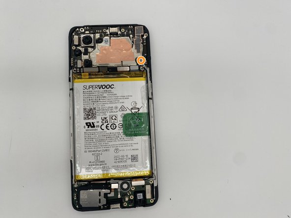

    • Disconnect the brackets attached to the motherboard with the help of a spudger.
    • Remove the 2.8 mm screw from the motherboard, using a Phillips #0 screwdriver, being careful not to damage any wires.

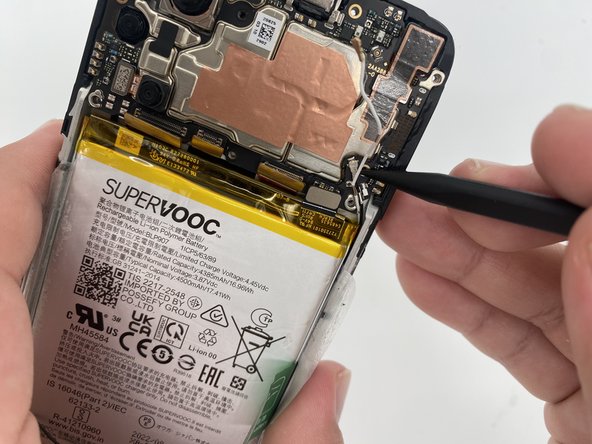

    • Remove the black and white wire from the motherboard using a spudger.
    • Pull back the front facing camera to make removing the board easier.

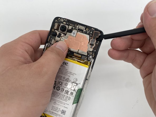

  7. OnePlus Nord N20 5G Earpiece Speaker Replacement: crwdns2935265:07crwdnd2935265:01crwdnd2935265:02crwdne2935265:0 OnePlus Nord N20 5G Earpiece Speaker Replacement: crwdns2935265:07crwdnd2935265:02crwdnd2935265:02crwdne2935265:0
    • Using a spudger, pull up the motherboard and remove it from the device.
