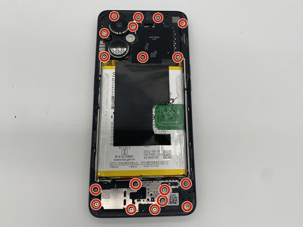

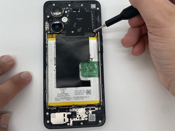

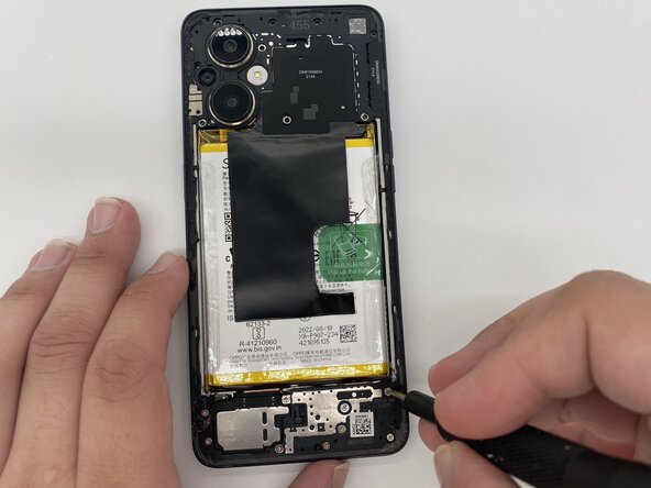

  3. OnePlus Nord N20 5G Battery Replacement, Battery: crwdns2935265:03crwdnd2935265:01crwdnd2935265:03crwdne2935265:0 OnePlus Nord N20 5G Battery Replacement, Battery: crwdns2935265:03crwdnd2935265:02crwdnd2935265:03crwdne2935265:0 OnePlus Nord N20 5G Battery Replacement, Battery: crwdns2935265:03crwdnd2935265:03crwdnd2935265:03crwdne2935265:0
    • Remove the eighteen 3.9 mm screws using a Phillips #0 screwdriver.

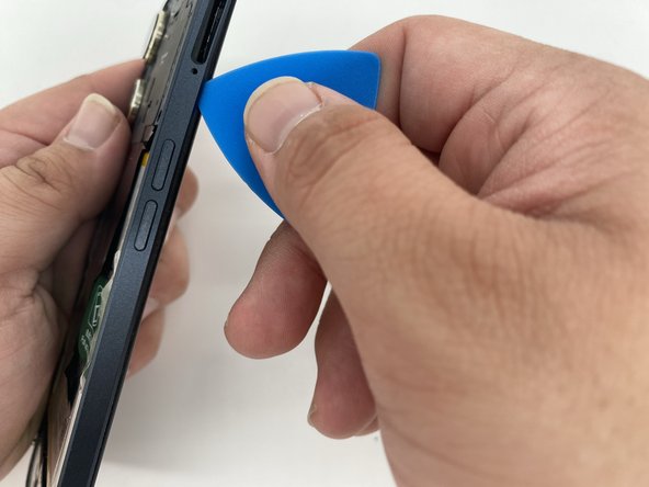

  4. OnePlus Nord N20 5G Battery Replacement: crwdns2935265:04crwdnd2935265:01crwdnd2935265:02crwdne2935265:0 OnePlus Nord N20 5G Battery Replacement: crwdns2935265:04crwdnd2935265:02crwdnd2935265:02crwdne2935265:0
    • Take the iFixit opening tool and run it along the edges of the frame.
    • Separate the back housing from the frame of the screen.

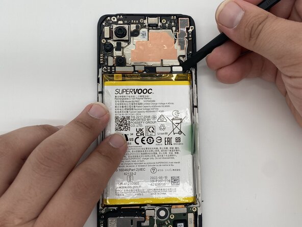

  5. OnePlus Nord N20 5G Battery Replacement: crwdns2935265:05crwdnd2935265:01crwdnd2935265:02crwdne2935265:0 OnePlus Nord N20 5G Battery Replacement: crwdns2935265:05crwdnd2935265:02crwdnd2935265:02crwdne2935265:0

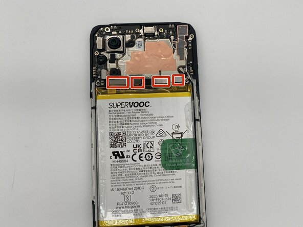

    • Disconnect the brackets attached to the motherboard with the help of a spudger.
  6. OnePlus Nord N20 5G Battery Replacement: crwdns2935265:06crwdnd2935265:01crwdnd2935265:02crwdne2935265:0 OnePlus Nord N20 5G Battery Replacement: crwdns2935265:06crwdnd2935265:02crwdnd2935265:02crwdne2935265:0

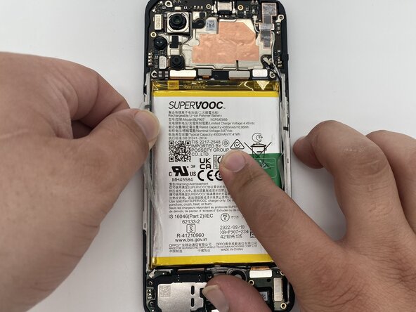

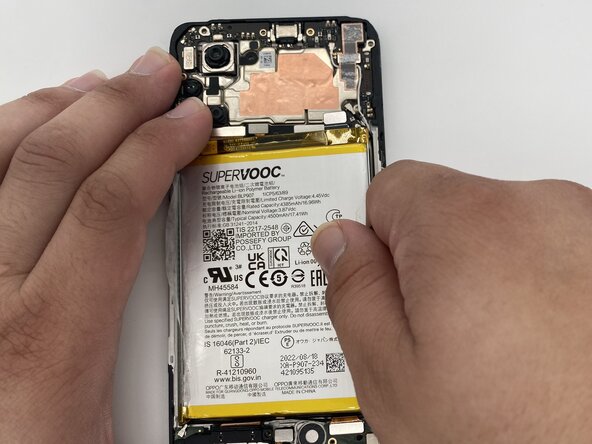

    • Remove the tape that's covering the battery.
    • Pull up the battery using the green tape on the right side of the battery.
    • Now you can replace the old battery with your new one.
