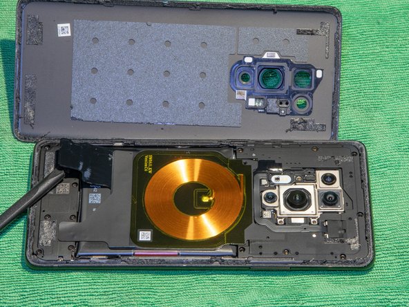

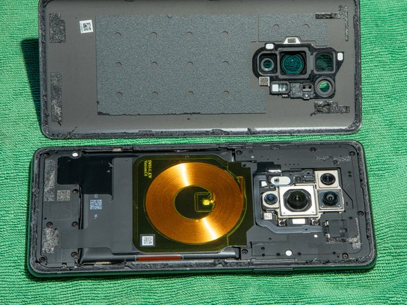

  3. OnePlus 8 Pro Battery Replacement: crwdns2935265:03crwdnd2935265:01crwdnd2935265:02crwdne2935265:0 OnePlus 8 Pro Battery Replacement: crwdns2935265:03crwdnd2935265:02crwdnd2935265:02crwdne2935265:0
    • Leave the opening picks once you managed to open one side.
    • Use heat on the next edge to open it.
    • Repeat steps 2 and 3 for all four edges.

be carefull: the adhesives of the back cover are not only on the edge, but also on the 4 corners (see the back cover on photo of step 4). You should carefully cut these off from the short edges, BEFORE trying to lift the cover.
