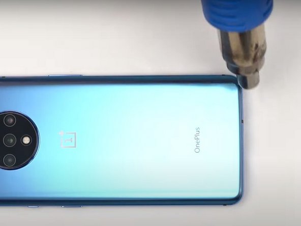

    • Use a heat gun to lightly heat the edges of the back to soften the adhesive that connects the back cover to the rest of the frame.
    • Using a heat gun, hair dryer, or hot plate will make the metal frame rather hot to the touch, so handle it with care.
    • Be careful not to overheat the device –the OLED display, battery and other internal parts can be damaged by excessive heat. Approximately one minute should be enough to soften the adhesive.
    • An iFixit iOpener, hairdryer, or hot plate can also be used to heat the edges. See the iOpener Heating guide for instructions on using the iOpener.

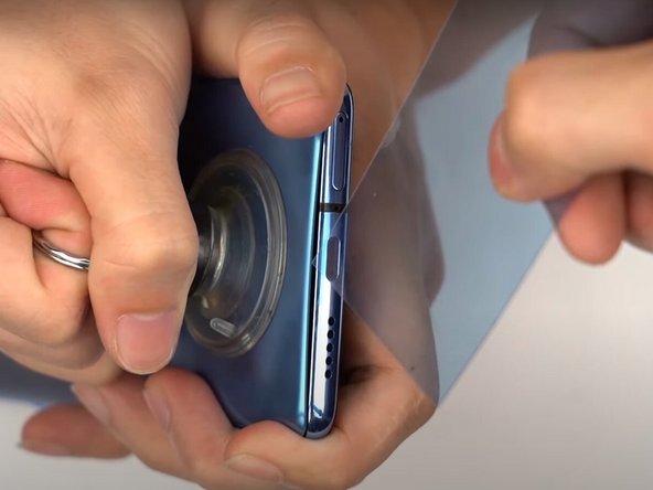

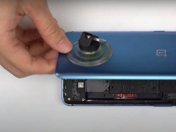

    • Apply a suction cup to the lower portion of the phone's backing and pull firmly to create a crack between the back cover and the rest of the phone.
    • Insert a Jimmy tool, opening pick, or plastic card under the edge of the back cover.

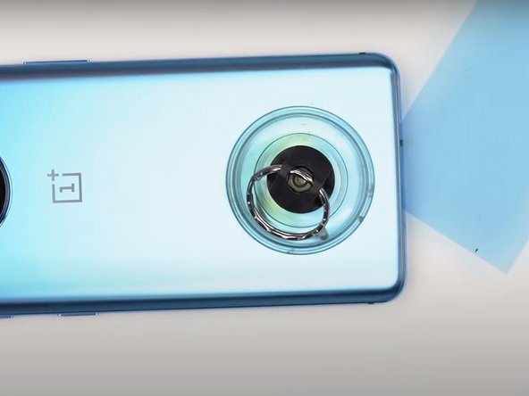

    • Use a plastic card or Jimmy tool to slice around the phone's seam, cutting through the adhesive.

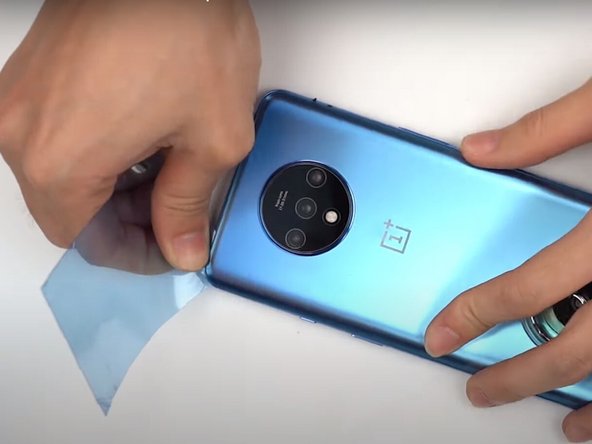

    • Remove the phone's back cover.
    • If you have replacement adhesive strips, remove any remaining adhesive from the device frame using the Jimmy tool.

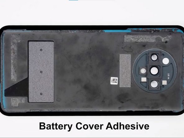

  6. OnePlus 7T  Battery Cover Replacement: crwdns2935265:06crwdnd2935265:01crwdnd2935265:02crwdne2935265:0 OnePlus 7T  Battery Cover Replacement: crwdns2935265:06crwdnd2935265:02crwdnd2935265:02crwdne2935265:0
    • Replace the battery cover adhesive.
