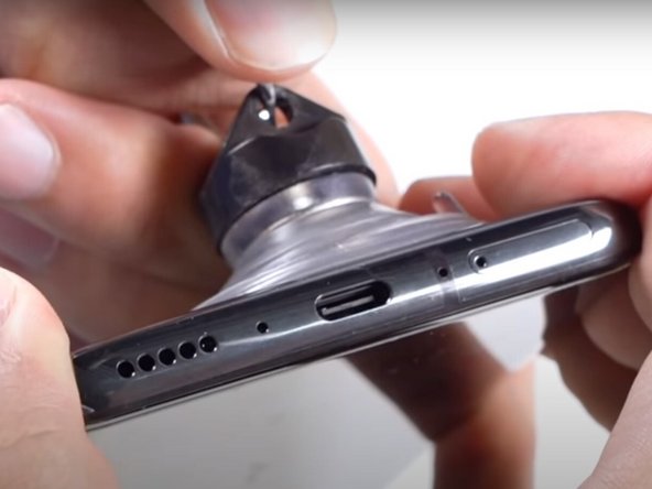

    3. OnePlus 7 Pro Screen Replacement: crwdns2935265:03crwdnd2935265:01crwdnd2935265:03crwdne2935265:0 OnePlus 7 Pro Screen Replacement: crwdns2935265:03crwdnd2935265:02crwdnd2935265:03crwdne2935265:0 OnePlus 7 Pro Screen Replacement: crwdns2935265:03crwdnd2935265:03crwdnd2935265:03crwdne2935265:0
      Plastic Cards
      $2.99
      • Apply a suction cup to the lower portion of the phone's backing and pull firmly to create a crack between the back cover and the rest of the phone.
      • Insert a Jimmy tool, opening pick, or plastic card under the edge of the back cover.

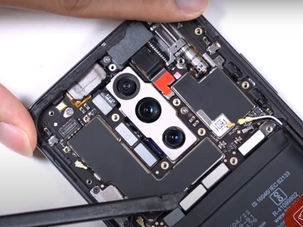

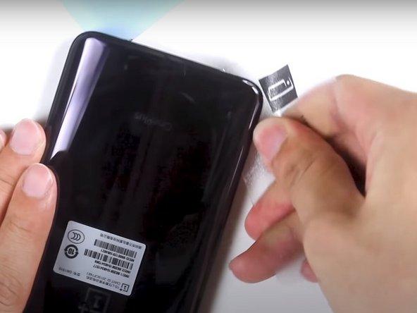

    5. OnePlus 7 Pro Screen Replacement: crwdns2935265:05crwdnd2935265:01crwdnd2935265:02crwdne2935265:0 OnePlus 7 Pro Screen Replacement: crwdns2935265:05crwdnd2935265:02crwdnd2935265:02crwdne2935265:0
      • Remove the phone's back cover.
      • If you have replacement adhesive strips, remove any remaining adhesive from the device frame using the Jimmy tool.
    6. OnePlus 7 Pro Screen Replacement: crwdns2935265:06crwdnd2935265:01crwdnd2935265:03crwdne2935265:0 OnePlus 7 Pro Screen Replacement: crwdns2935265:06crwdnd2935265:02crwdnd2935265:03crwdne2935265:0 OnePlus 7 Pro Screen Replacement: crwdns2935265:06crwdnd2935265:03crwdnd2935265:03crwdne2935265:0

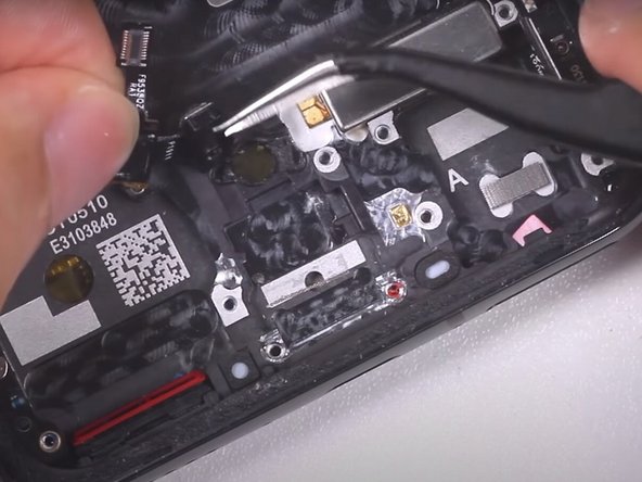

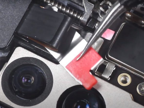

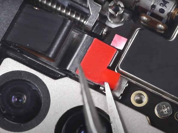

      • Use a pair of tweezers to lift up the piece of black tape covering the laser autofocus and flash flex cable.
      • Use a pair of tweezers to lift and remove the covering on the laser autofocus and flash flex cable.
    7. OnePlus 7 Pro Screen Replacement: crwdns2935265:07crwdnd2935265:01crwdnd2935265:01crwdne2935265:0
      • Use the flat end of a spudger to disconnect the laser autofocus and flash flex cable.

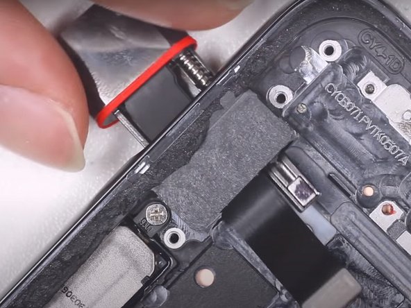

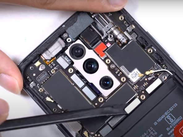

      • Use a pair of tweezers to pry up the red plastic tab.
      • Use a pair of tweezers to remove the assembly connected to the red plastic tab.
    16. OnePlus 7 Pro Screen Replacement: crwdns2935265:016crwdnd2935265:01crwdnd2935265:01crwdne2935265:0
      • Use the flat end of a spudger to disconnect the connector that was underneath the red plastic tab.
    17. OnePlus 7 Pro Screen Replacement: crwdns2935265:017crwdnd2935265:01crwdnd2935265:02crwdne2935265:0 OnePlus 7 Pro Screen Replacement: crwdns2935265:017crwdnd2935265:02crwdnd2935265:02crwdne2935265:0
      • Use a Phillips #000 screwdriver to remove the remaining two screws securing the motherboard.
    18. OnePlus 7 Pro Screen Replacement: crwdns2935265:018crwdnd2935265:01crwdnd2935265:03crwdne2935265:0 OnePlus 7 Pro Screen Replacement: crwdns2935265:018crwdnd2935265:02crwdnd2935265:03crwdne2935265:0 OnePlus 7 Pro Screen Replacement: crwdns2935265:018crwdnd2935265:03crwdnd2935265:03crwdne2935265:0
      • Use the flat end of a spudger to lift up the phone's motherboard.
      • Remove the motherboard.

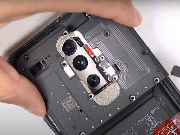

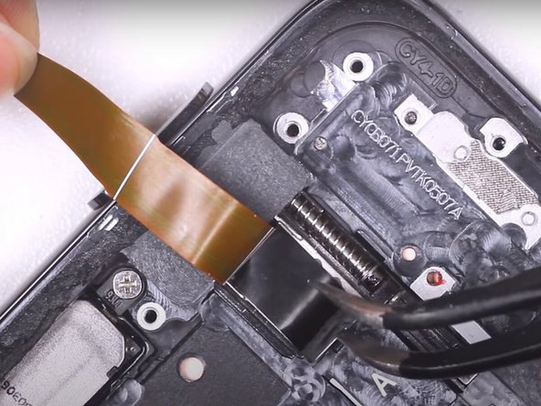

      • Use a pair of tweezers to remove the camera elevator assembly.
    21. OnePlus 7 Pro Screen Replacement: crwdns2935265:021crwdnd2935265:01crwdnd2935265:03crwdne2935265:0 OnePlus 7 Pro Screen Replacement: crwdns2935265:021crwdnd2935265:02crwdnd2935265:03crwdne2935265:0 OnePlus 7 Pro Screen Replacement: crwdns2935265:021crwdnd2935265:03crwdnd2935265:03crwdne2935265:0

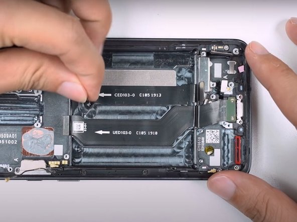

      • Lift up the large flex cable with your fingers.
      • Use a pair of tweezers to remove the black plastic screw covering.

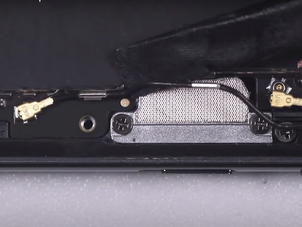

    22. OnePlus 7 Pro Screen Replacement: crwdns2935265:022crwdnd2935265:01crwdnd2935265:03crwdne2935265:0 OnePlus 7 Pro Screen Replacement: crwdns2935265:022crwdnd2935265:02crwdnd2935265:03crwdne2935265:0 OnePlus 7 Pro Screen Replacement: crwdns2935265:022crwdnd2935265:03crwdnd2935265:03crwdne2935265:0
      • Use a Phillips #000 screwdriver to remove two small screws from the metal covering.
      • Remove the metal covering.

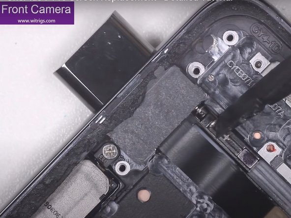

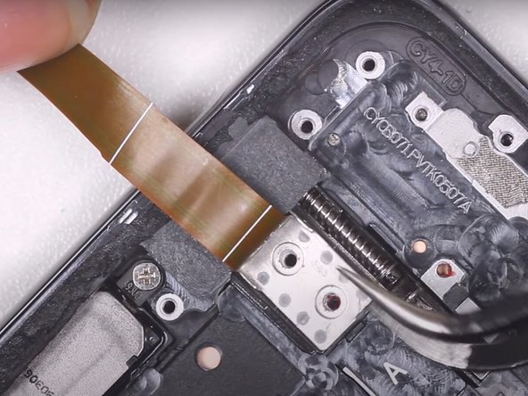

    23. OnePlus 7 Pro Screen Replacement: crwdns2935265:023crwdnd2935265:01crwdnd2935265:03crwdne2935265:0 OnePlus 7 Pro Screen Replacement: crwdns2935265:023crwdnd2935265:02crwdnd2935265:03crwdne2935265:0 OnePlus 7 Pro Screen Replacement: crwdns2935265:023crwdnd2935265:03crwdnd2935265:03crwdne2935265:0

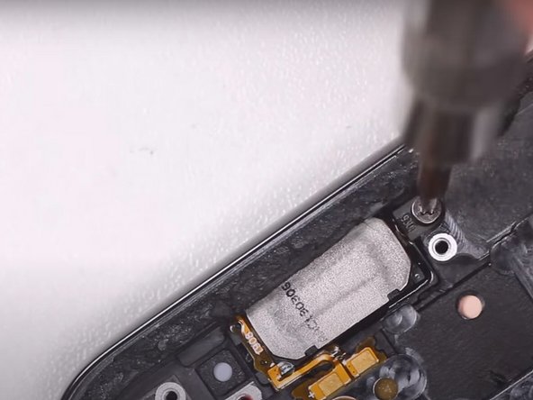

      • Use the flat end of a spudger or your fingers to gently remove the front camera assembly.

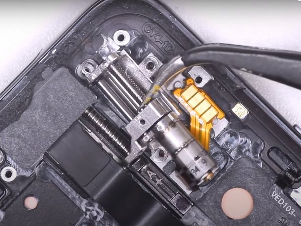

    24. OnePlus 7 Pro Screen Replacement: crwdns2935265:024crwdnd2935265:01crwdnd2935265:02crwdne2935265:0 OnePlus 7 Pro Screen Replacement: crwdns2935265:024crwdnd2935265:02crwdnd2935265:02crwdne2935265:0

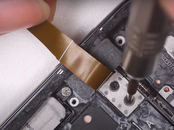

      • Use a Phillips #000 screwdriver to remove one screw in the upper left-hand corner.
    25. OnePlus 7 Pro Screen Replacement: crwdns2935265:025crwdnd2935265:01crwdnd2935265:03crwdne2935265:0 OnePlus 7 Pro Screen Replacement: crwdns2935265:025crwdnd2935265:02crwdnd2935265:03crwdne2935265:0 OnePlus 7 Pro Screen Replacement: crwdns2935265:025crwdnd2935265:03crwdnd2935265:03crwdne2935265:0

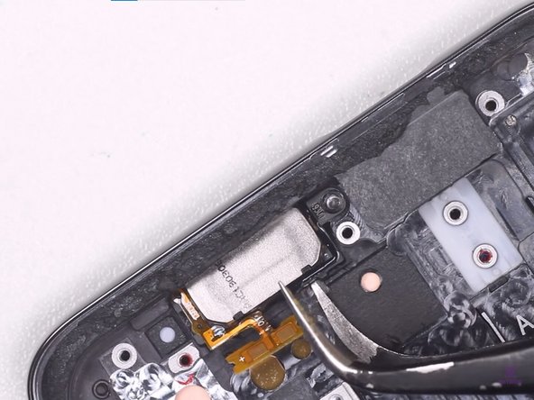

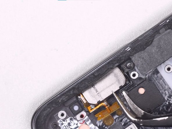

      • Use a pair of tweezers to disconnect the earpiece's yellow flex cable.
      • Use a pair of tweezers to remove the earpice.

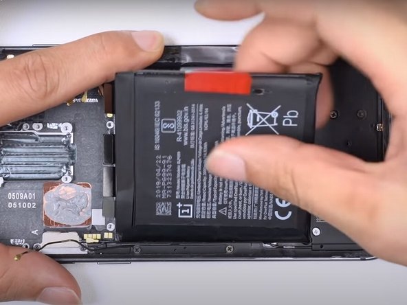

    26. OnePlus 7 Pro Screen Replacement: crwdns2935265:026crwdnd2935265:01crwdnd2935265:02crwdne2935265:0 OnePlus 7 Pro Screen Replacement: crwdns2935265:026crwdnd2935265:02crwdnd2935265:02crwdne2935265:0
      • Use your fingers to pull on the red sticker labelled 'Pull Up From This Side.'
      • Remove the battery.

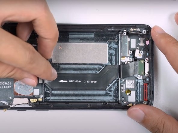

    27. OnePlus 7 Pro Screen Replacement: crwdns2935265:027crwdnd2935265:01crwdnd2935265:03crwdne2935265:0 OnePlus 7 Pro Screen Replacement: crwdns2935265:027crwdnd2935265:02crwdnd2935265:03crwdne2935265:0 OnePlus 7 Pro Screen Replacement: crwdns2935265:027crwdnd2935265:03crwdnd2935265:03crwdne2935265:0
      • Use your fingers to grab the black tab and remove the plastic that was underneath the battery.

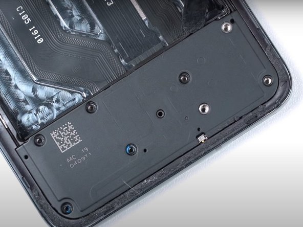

    28. OnePlus 7 Pro Screen Replacement: crwdns2935265:028crwdnd2935265:01crwdnd2935265:02crwdne2935265:0 OnePlus 7 Pro Screen Replacement: crwdns2935265:028crwdnd2935265:02crwdnd2935265:02crwdne2935265:0
      • Use a Phillips #000 screwdriver to remove eight screws from the bottom panel.
      • Use the flat end of a spudger to pry up the bottom cover.
      • Remove the bottom cover.

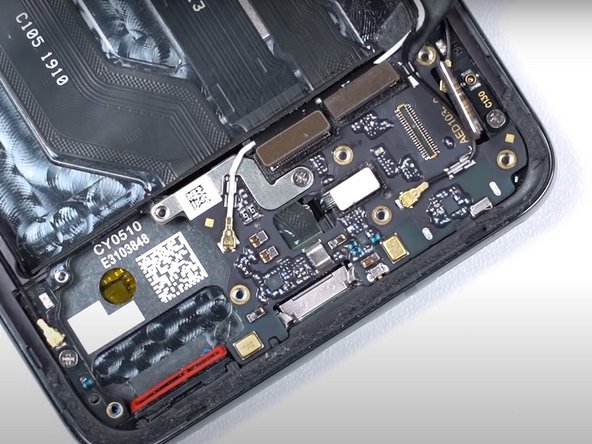

    29. OnePlus 7 Pro Screen Replacement: crwdns2935265:029crwdnd2935265:01crwdnd2935265:01crwdne2935265:0

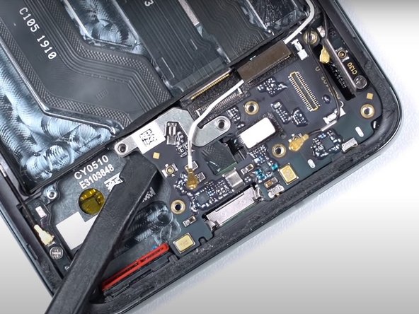

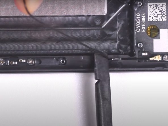

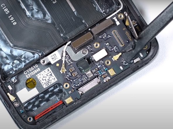

      • Use the flat end of a spudger to disconnect the fingerprint sensor, the LED flex cable, the CED flex cable, and the display and touch flex cable.
    30. OnePlus 7 Pro Screen Replacement: crwdns2935265:030crwdnd2935265:01crwdnd2935265:03crwdne2935265:0 OnePlus 7 Pro Screen Replacement: crwdns2935265:030crwdnd2935265:02crwdnd2935265:03crwdne2935265:0 OnePlus 7 Pro Screen Replacement: crwdns2935265:030crwdnd2935265:03crwdnd2935265:03crwdne2935265:0

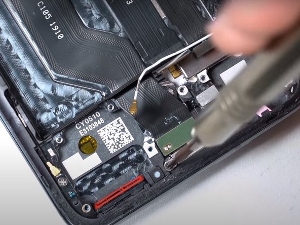

      • Use the flat end of a spudger to disconnect the three coaxial cables near the bottom of the phone.
      • To disconnect the longer coaxial cable, you will need to pry the wire from its clips.

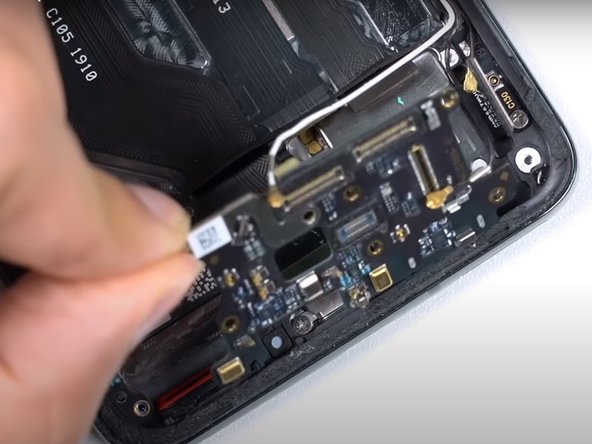

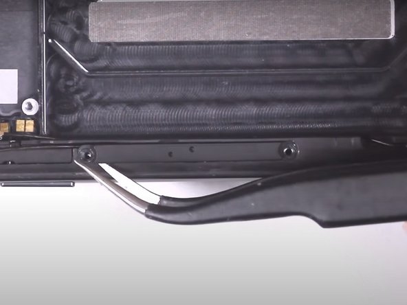

    31. OnePlus 7 Pro Screen Replacement: crwdns2935265:031crwdnd2935265:01crwdnd2935265:03crwdne2935265:0 OnePlus 7 Pro Screen Replacement: crwdns2935265:031crwdnd2935265:02crwdnd2935265:03crwdne2935265:0 OnePlus 7 Pro Screen Replacement: crwdns2935265:031crwdnd2935265:03crwdnd2935265:03crwdne2935265:0
      • Use a Phillips #000 screwdriver to remove one screw.
      • Use the flat end of a spudger to lift up the sub-board.
      • Remove the phone's sub-board.

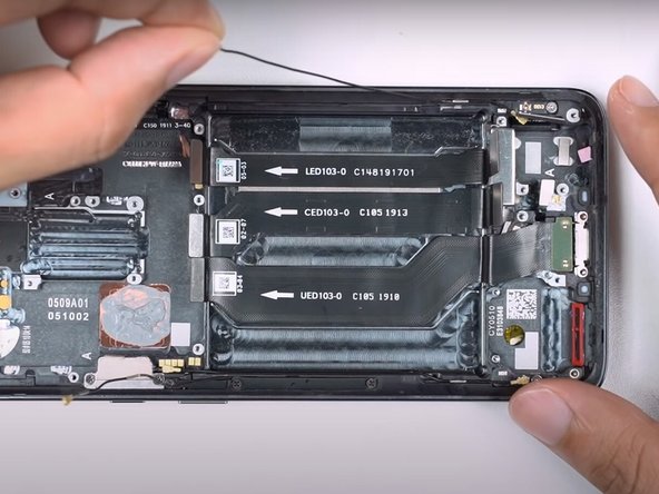

    32. OnePlus 7 Pro Screen Replacement: crwdns2935265:032crwdnd2935265:01crwdnd2935265:02crwdne2935265:0 OnePlus 7 Pro Screen Replacement: crwdns2935265:032crwdnd2935265:02crwdnd2935265:02crwdne2935265:0
      • Use a Phillips #000 screwdriver to remove two screws.
    33. OnePlus 7 Pro Screen Replacement: crwdns2935265:033crwdnd2935265:01crwdnd2935265:03crwdne2935265:0 OnePlus 7 Pro Screen Replacement: crwdns2935265:033crwdnd2935265:02crwdnd2935265:03crwdne2935265:0 OnePlus 7 Pro Screen Replacement: crwdns2935265:033crwdnd2935265:03crwdnd2935265:03crwdne2935265:0

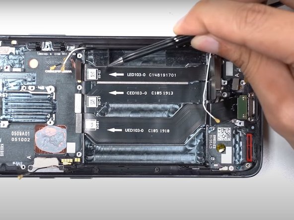

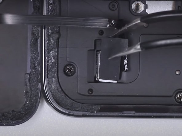

      • Use a pair of tweezers to peel out the black stickers from the sides and bottom of the battery area.
    34. OnePlus 7 Pro Screen Replacement: crwdns2935265:034crwdnd2935265:01crwdnd2935265:02crwdne2935265:0 OnePlus 7 Pro Screen Replacement: crwdns2935265:034crwdnd2935265:02crwdnd2935265:02crwdne2935265:0

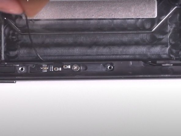

      • Use your fingers to remove the three signal cables.
    35. OnePlus 7 Pro Screen Replacement: crwdns2935265:035crwdnd2935265:01crwdnd2935265:01crwdne2935265:0
      • Use the flat end of a spudger to disconnect the USB port flex cable.

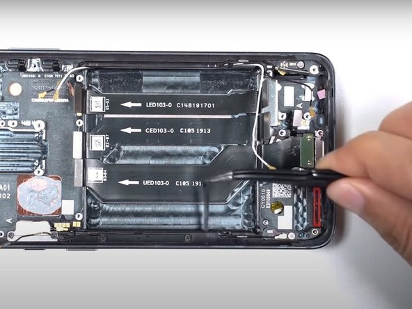

    36. OnePlus 7 Pro Screen Replacement: crwdns2935265:036crwdnd2935265:01crwdnd2935265:03crwdne2935265:0 OnePlus 7 Pro Screen Replacement: crwdns2935265:036crwdnd2935265:02crwdnd2935265:03crwdne2935265:0 OnePlus 7 Pro Screen Replacement: crwdns2935265:036crwdnd2935265:03crwdnd2935265:03crwdne2935265:0
      • Use your fingers to remove the LED flex cable, CED flex cable, and USB port cable.

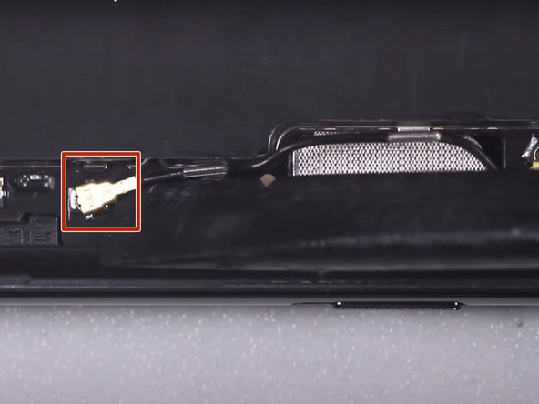

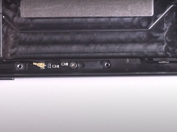

      • Disconnect the coaxial cable in the lower left-hand corner using the flat end of a spudger.

      • Remove the coaxial cable using the flat end of a spudger.
      • Remove the coaxial cable from the left-hand side of the battery's area.
