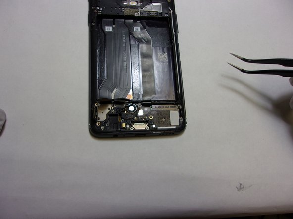

    4. OnePlus 6 Screen Replacement: crwdns2935265:012crwdnd2935265:01crwdnd2935265:01crwdne2935265:0
      • Using tweezers, lift the circuit board from the assembly and remove it.
    5. OnePlus 6 Screen Replacement: crwdns2935265:013crwdnd2935265:01crwdnd2935265:01crwdne2935265:0

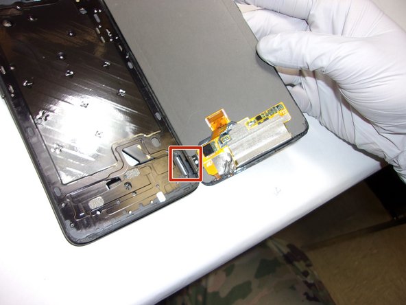

      • Use a heat gun set to its lowest temperature, gently heat the perimeter of the screen to loosen the adhesive.
      • Wedge an opening pick between the screen and the chassis, then slide it around the entire perimeter of the screen to break the adhesive.
      • Gently pry the screen away from the chassis.
      • Reheat the perimeter as needed.
    6. OnePlus 6 Screen Replacement: crwdns2935265:014crwdnd2935265:01crwdnd2935265:02crwdne2935265:0 OnePlus 6 Screen Replacement: crwdns2935265:014crwdnd2935265:02crwdnd2935265:02crwdne2935265:0
      • After gently prying the screen from the frame, carefully thread the tab through the bracket to remove the screen from the phone.
