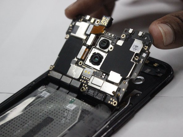

  6. OnePlus 6 Rear Camera Replacement, Motherboard: crwdns2935265:06crwdnd2935265:01crwdnd2935265:01crwdne2935265:0
    • Remove the ten screws holding the motherboard using a Phillips #00 screwdriver.
  7. OnePlus 6 Rear Camera Replacement: crwdns2935265:07crwdnd2935265:01crwdnd2935265:02crwdne2935265:0 OnePlus 6 Rear Camera Replacement: crwdns2935265:07crwdnd2935265:02crwdnd2935265:02crwdne2935265:0
    • Disconnect the small metal tabs near the battery compartment that are holding the motherboard down.
    • Using a fingernail, carefully work under the edge and pry the motherboard up from the phone.
    • The cameras should lift up with the motherboard.

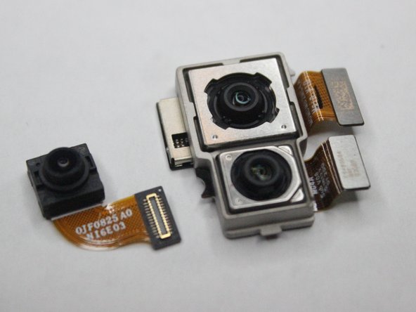

  8. OnePlus 6 Rear Camera Replacement, Rear Camera: crwdns2935265:08crwdnd2935265:01crwdnd2935265:02crwdne2935265:0 OnePlus 6 Rear Camera Replacement, Rear Camera: crwdns2935265:08crwdnd2935265:02crwdnd2935265:02crwdne2935265:0
    • Lift up on the small tabs connecting the cameras to the motherboard to disconnect them.
    • Push on the lens side of the cameras and remove them from the motherboard.
