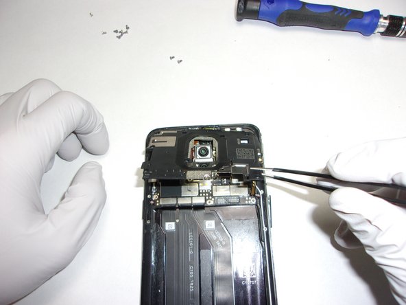

  2. OnePlus 6 Front Facing Camera Replacement: crwdns2935265:02crwdnd2935265:01crwdnd2935265:02crwdne2935265:0 OnePlus 6 Front Facing Camera Replacement: crwdns2935265:02crwdnd2935265:02crwdnd2935265:02crwdne2935265:0
    • Use tweezers to disconnect the red pull-away tab up from the motherboard.
    • Detach the orange camera ribbon cable, below the red tab, using the tweezers.
    • Grip the green tab and lift the battery up and out of the chassis.
  3. OnePlus 6 Front Facing Camera Replacement: crwdns2935265:03crwdnd2935265:01crwdnd2935265:02crwdne2935265:0 OnePlus 6 Front Facing Camera Replacement: crwdns2935265:03crwdnd2935265:02crwdnd2935265:02crwdne2935265:0
    • Use a Phillips #000 screwdriver to remove the ten screws from the motherboard harness.
    • Pull the motherboard harness up using the tweezers

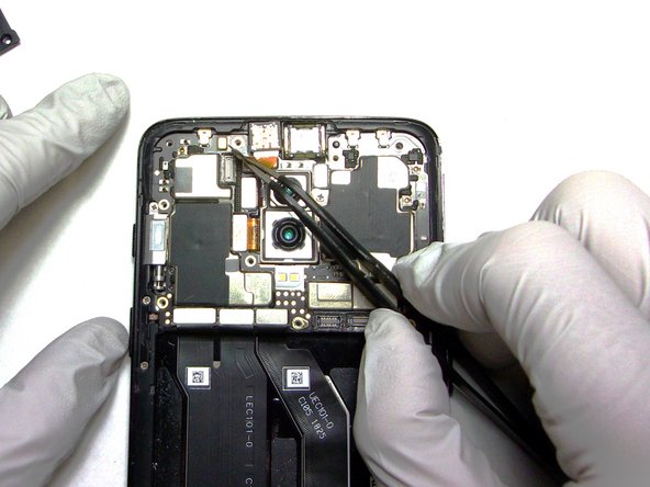

  4. OnePlus 6 Front Facing Camera Replacement: crwdns2935265:04crwdnd2935265:01crwdnd2935265:02crwdne2935265:0 OnePlus 6 Front Facing Camera Replacement: crwdns2935265:04crwdnd2935265:02crwdnd2935265:02crwdne2935265:0
    • Use the pointed tip of a spudger to lift the front-facing camera's pin connection, gently prying on the plug vertically until it completely releases.
    • Lift the front-facing camera up and out using tweezers.
