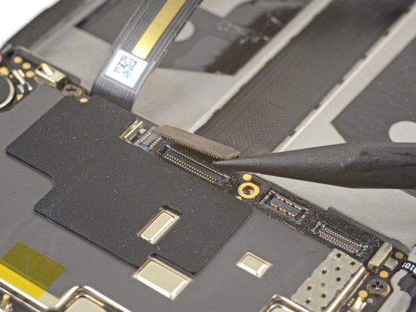

      • Use the point of a spudger to pry up and disconnect the display interconnect cable from its socket near the bottom edge of the motherboard.

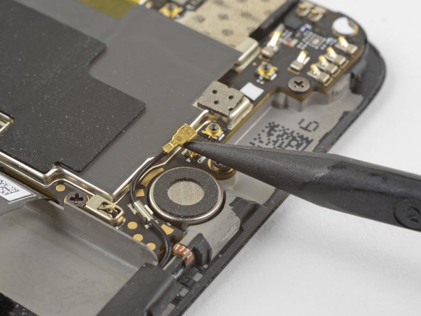

      • Slide the point of a spudger underneath the antenna interconnect cable that is connected to the motherboard above the vibration motor.
      • Pry up to disconnect the cable from its socket.
      • De-route the cable out of its motherboard grounding clip and move it out of the way.

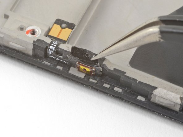

      • Try not to tear the black tape pieces in this step so that you can reuse them during re-assembly. If you do tear the tape, replace them with pieces of electrical tape.
      • Use tweezers or the point of a spudger to pry up and remove the black tape covering the volume buttons on the right edge of the phone.
      • Repeat the process with the black tape covering the power button on the left edge of the phone.

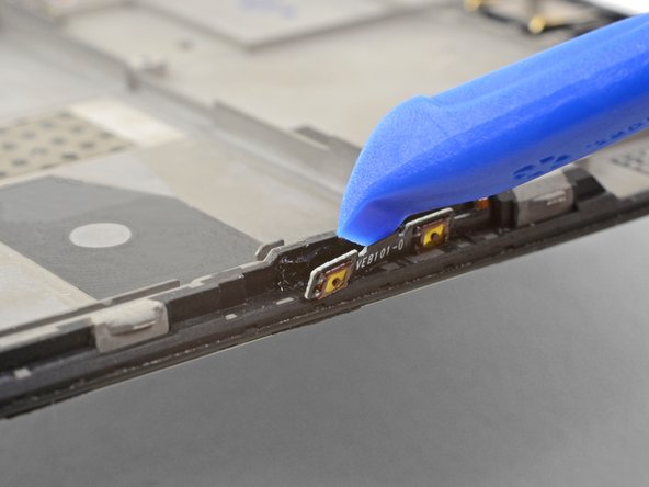

      • Use the edge of an opening tool to gently pry the volume button board away from the frame.
      • If the volume button board begins to bend significantly, stop and pry from a different angle.
      • Continue prying until you loosen the volume button board from the frame.

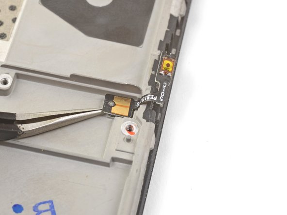

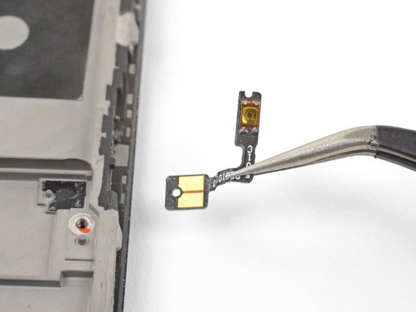

      • Squeeze the tweezer tips together and insert the point underneath the volume button board's contact pad near the top right edge of the frame.
      • Pry upwards to loosen the contact pad from the frame.
      • Remove the volume buttons.
