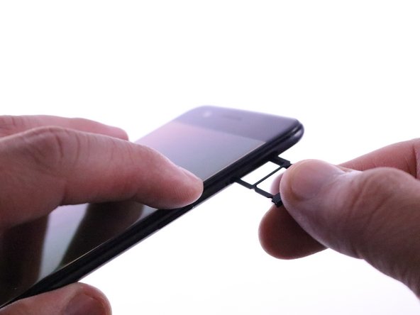

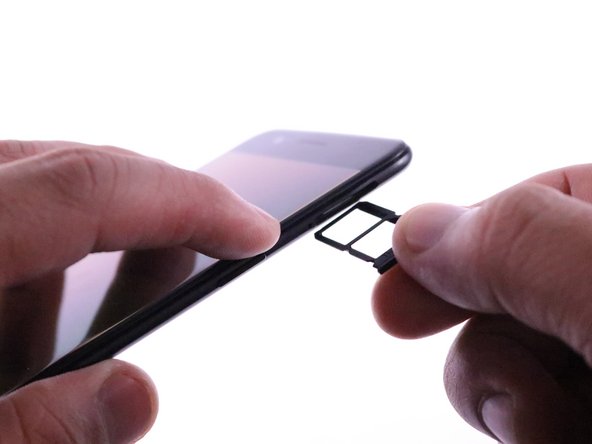

  3. OnePlus 5 Speaker Replacement: crwdns2935265:03crwdnd2935265:01crwdnd2935265:03crwdne2935265:0 OnePlus 5 Speaker Replacement: crwdns2935265:03crwdnd2935265:02crwdnd2935265:03crwdne2935265:0 OnePlus 5 Speaker Replacement: crwdns2935265:03crwdnd2935265:03crwdnd2935265:03crwdne2935265:0
    • Locate the sim card on the right side of the phone.
    • Insert the SIM ejector screwdriver bit into the hole left of the sim card holder by applying pressure.
    • It is also okay to use the SIM card eject tool for this step.
    • Remove the sim card holder by pulling it out with your fingers.

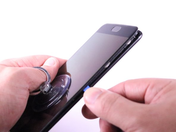

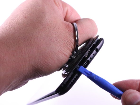

  4. OnePlus 5 Speaker Replacement: crwdns2935265:04crwdnd2935265:01crwdnd2935265:03crwdne2935265:0 OnePlus 5 Speaker Replacement: crwdns2935265:04crwdnd2935265:02crwdnd2935265:03crwdne2935265:0 OnePlus 5 Speaker Replacement: crwdns2935265:04crwdnd2935265:03crwdnd2935265:03crwdne2935265:0
    • Insert the plastic iFixit opening tool between the the plastic rim of the screen and the metal edge of the phone.
    • Place a suction cup on the screen to gain more leverage when separating the screen from the back plate.
    • Moving right to left around the phone, carefully pry the screen away from the back plate by wiggling the iFixit opening tool and pulling the suction cup in the opposite direction.
    • When reassembling, apply pressure to the edges of the screen and back plate together until they pop back into place.

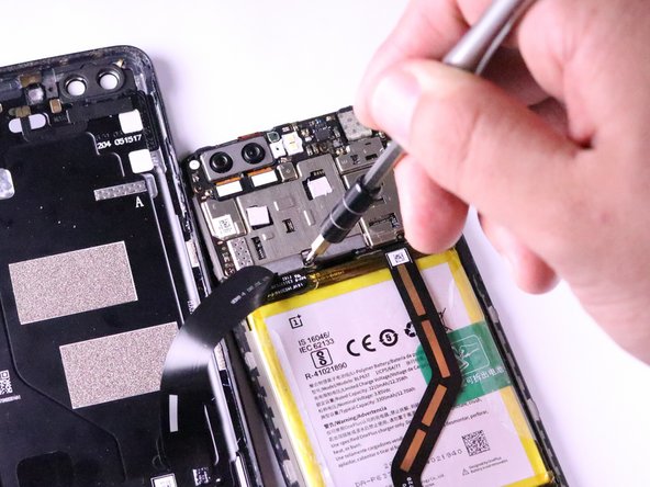

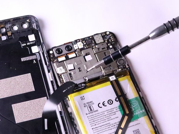

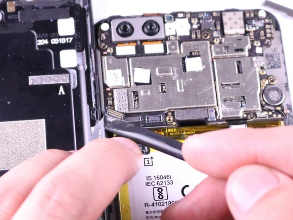

  5. OnePlus 5 Speaker Replacement: crwdns2935265:05crwdnd2935265:01crwdnd2935265:03crwdne2935265:0 OnePlus 5 Speaker Replacement: crwdns2935265:05crwdnd2935265:02crwdnd2935265:03crwdne2935265:0 OnePlus 5 Speaker Replacement: crwdns2935265:05crwdnd2935265:03crwdnd2935265:03crwdne2935265:0
    • Locate the metal connector cap on the upper half of the device directly above the battery.
    • Remove the 1mm Phillips #0 screw from the metal connector cap by rotating the screwdriver counter-clockwise.

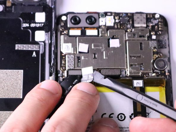

  6. OnePlus 5 Speaker Replacement: crwdns2935265:06crwdnd2935265:01crwdnd2935265:02crwdne2935265:0 OnePlus 5 Speaker Replacement: crwdns2935265:06crwdnd2935265:02crwdnd2935265:02crwdne2935265:0
    • Carefully pop out the metal connector cap with the nylon spudger and remove it by pulling up.

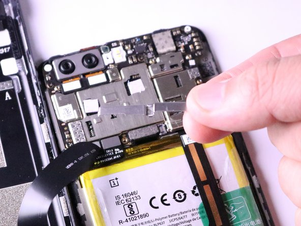

  7. OnePlus 5 Speaker Replacement: crwdns2935265:07crwdnd2935265:01crwdnd2935265:03crwdne2935265:0 OnePlus 5 Speaker Replacement: crwdns2935265:07crwdnd2935265:02crwdnd2935265:03crwdne2935265:0 OnePlus 5 Speaker Replacement: crwdns2935265:07crwdnd2935265:03crwdnd2935265:03crwdne2935265:0
    • Locate the two connectors directly above the battery on the left side of the device.
    • Remove the battery connector cable located to the right of the charging port connector cable using a nylon spudger by prying underneath it and popping it up.
    • Remove the charging port connector cable to the left of the battery cable using a nylon spudger by prying underneath it and popping it up.

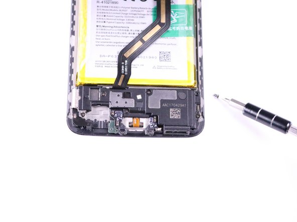

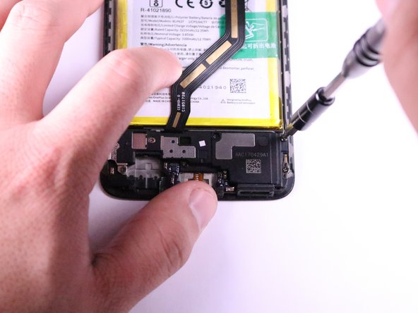

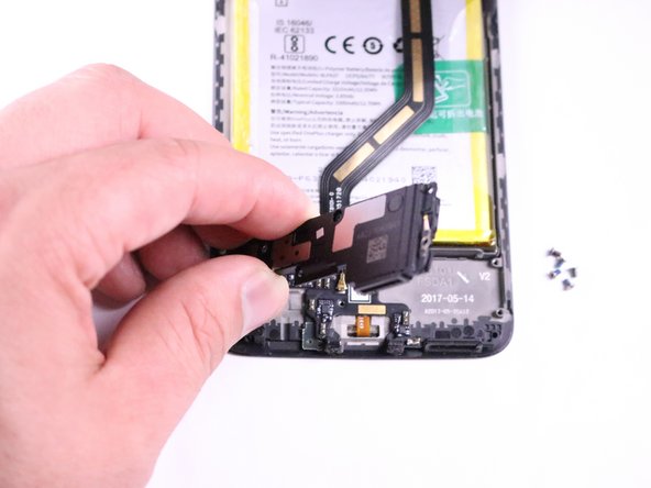

  8. OnePlus 5 Speaker Replacement, Loudspeaker: crwdns2935265:08crwdnd2935265:01crwdnd2935265:03crwdne2935265:0 OnePlus 5 Speaker Replacement, Loudspeaker: crwdns2935265:08crwdnd2935265:02crwdnd2935265:03crwdne2935265:0 OnePlus 5 Speaker Replacement, Loudspeaker: crwdns2935265:08crwdnd2935265:03crwdnd2935265:03crwdne2935265:0
    • Remove the six 1mm Phillips #0 screws by rotating the screwdriver counter-clockwise.

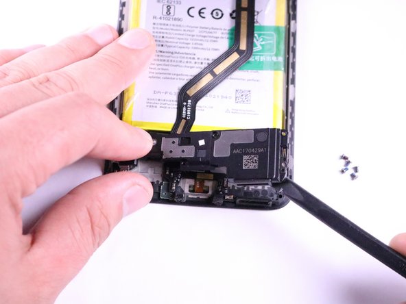

  9. OnePlus 5 Speaker Replacement: crwdns2935265:09crwdnd2935265:01crwdnd2935265:03crwdne2935265:0 OnePlus 5 Speaker Replacement: crwdns2935265:09crwdnd2935265:02crwdnd2935265:03crwdne2935265:0 OnePlus 5 Speaker Replacement: crwdns2935265:09crwdnd2935265:03crwdnd2935265:03crwdne2935265:0
    • Remove the loudspeaker by gently pushing the spudger underneath it and prying it out.
