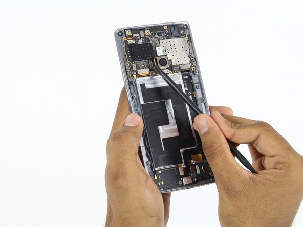

  7. OnePlus 2 Front and Rear Camera Replacement, Front and Rear Camera: crwdns2935265:07crwdnd2935265:01crwdnd2935265:03crwdne2935265:0 OnePlus 2 Front and Rear Camera Replacement, Front and Rear Camera: crwdns2935265:07crwdnd2935265:02crwdnd2935265:03crwdne2935265:0 OnePlus 2 Front and Rear Camera Replacement, Front and Rear Camera: crwdns2935265:07crwdnd2935265:03crwdnd2935265:03crwdne2935265:0
    • Use the spudger tool to pry off the connections at the bottom-right of the front-facing camera.
    • Be sure to disconnect both connections before attempting to lift off the wiring.

This is awesome guide. My 20 days old onePlus2 lens broke, when my pocket hit the table while I had the phone in there. After reading in the forum about the OnePlus customer service, I did not bother calling OnePlus. I ordered the lens for $5 from parts4repair.com. Followed this awesome directions and replaced the lens without a glitch.
BIG BIG BIG KUDOS to Kayla Williams. This really saved me a lot of time and trouble and made my phone worth again. I can't thank you enough.
