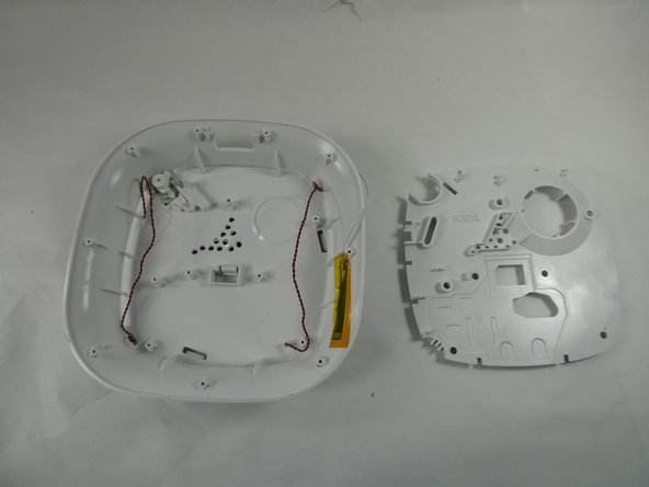

  12. OneLink Safe and Sound Speaker Replacement: crwdns2935265:012crwdnd2935265:01crwdnd2935265:02crwdne2935265:0 OneLink Safe and Sound Speaker Replacement: crwdns2935265:012crwdnd2935265:02crwdnd2935265:02crwdne2935265:0
    • Use a Phillips #0 screwdriver to remove seven screws securing the white base and motherboard.
  13. OneLink Safe and Sound Speaker Replacement: crwdns2935265:013crwdnd2935265:01crwdnd2935265:03crwdne2935265:0 OneLink Safe and Sound Speaker Replacement: crwdns2935265:013crwdnd2935265:02crwdnd2935265:03crwdne2935265:0 OneLink Safe and Sound Speaker Replacement: crwdns2935265:013crwdnd2935265:03crwdnd2935265:03crwdne2935265:0
    • Gently remove the motherboard.
  14. OneLink Safe and Sound Speaker Replacement, Speaker: crwdns2935265:014crwdnd2935265:01crwdnd2935265:02crwdne2935265:0 OneLink Safe and Sound Speaker Replacement, Speaker: crwdns2935265:014crwdnd2935265:02crwdnd2935265:02crwdne2935265:0
    • Remove the speaker cables from the channels along the edge of the speaker cover.
    • Use an opening tool or your fingers to lift the speaker cover off of the back cover which houses the speakers.
  15. OneLink Safe and Sound Speaker Replacement: crwdns2935265:015crwdnd2935265:01crwdnd2935265:01crwdne2935265:0
    • When the speaker cover is removed the speakers can be replaced.
