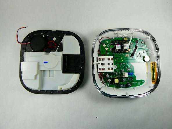

    • Run the metal spudger under the plastic rim and around the perimeter, on the top of the device to loosen the adhesive.
    • Remove plastic rim.
  2. OneLink Safe and Sound Motherboard Replacement: crwdns2935265:02crwdnd2935265:01crwdnd2935265:02crwdne2935265:0 OneLink Safe and Sound Motherboard Replacement: crwdns2935265:02crwdnd2935265:02crwdnd2935265:02crwdne2935265:0
    • Use a Phillips #0 screwdriver to remove nine screws from the top of the device.
  3. OneLink Safe and Sound Motherboard Replacement: crwdns2935265:03crwdnd2935265:01crwdnd2935265:02crwdne2935265:0 OneLink Safe and Sound Motherboard Replacement: crwdns2935265:03crwdnd2935265:02crwdnd2935265:02crwdne2935265:0
    • Don't yank or pull the lid off as there are ribbons and cables connecting the top of the device to the motherboard. They need to be disconnected before the top is removed.
    • Use tweezers or a spudger to disconnect the ribbon from the motherboard.
  4. OneLink Safe and Sound Motherboard Replacement: crwdns2935265:04crwdnd2935265:01crwdnd2935265:01crwdne2935265:0
    • Use tweezers to unplug the speaker cable from the motherboard.
  5. OneLink Safe and Sound Motherboard Replacement: crwdns2935265:05crwdnd2935265:01crwdnd2935265:02crwdne2935265:0 OneLink Safe and Sound Motherboard Replacement: crwdns2935265:05crwdnd2935265:02crwdnd2935265:02crwdne2935265:0
    • Use the plastic opening tool to remove the microphone connection from the motherboard.
    • Remove the top of the device.

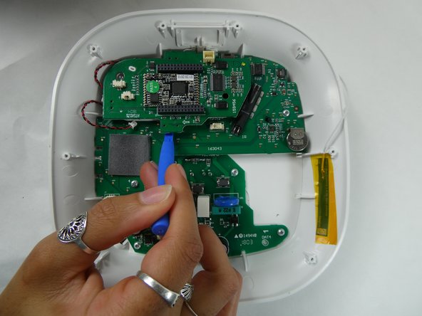

  6. OneLink Safe and Sound Motherboard Replacement, Battery: crwdns2935265:06crwdnd2935265:01crwdnd2935265:01crwdne2935265:0
    • Use the plastic opening tool to disconnect the cable from the motherboard.

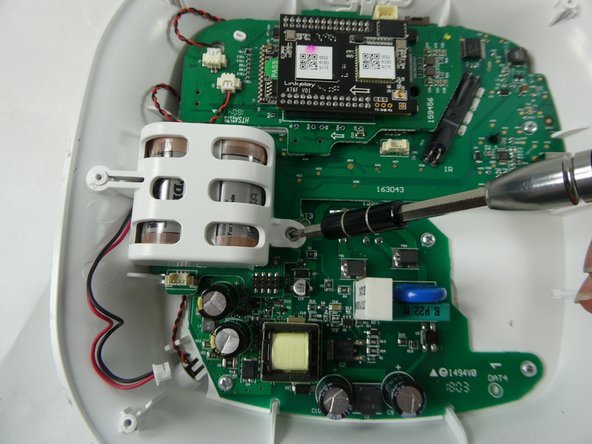

  7. OneLink Safe and Sound Motherboard Replacement: crwdns2935265:07crwdnd2935265:01crwdnd2935265:02crwdne2935265:0 OneLink Safe and Sound Motherboard Replacement: crwdns2935265:07crwdnd2935265:02crwdnd2935265:02crwdne2935265:0
    • Use a Phillips #0 screwdriver to remove the single screw securing the plastic battery cage.

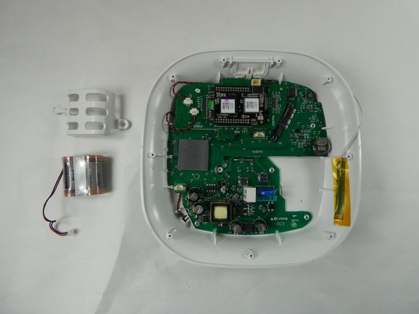

  8. OneLink Safe and Sound Motherboard Replacement: crwdns2935265:08crwdnd2935265:01crwdnd2935265:02crwdne2935265:0 OneLink Safe and Sound Motherboard Replacement: crwdns2935265:08crwdnd2935265:02crwdnd2935265:02crwdne2935265:0
    • Remove the plastic cage holding the battery in place.
    • Remove the battery from the device.

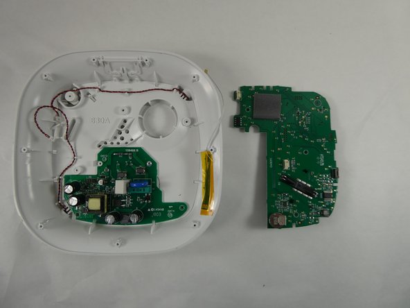

  11. OneLink Safe and Sound Motherboard Replacement, Motherboard: crwdns2935265:011crwdnd2935265:01crwdnd2935265:03crwdne2935265:0 OneLink Safe and Sound Motherboard Replacement, Motherboard: crwdns2935265:011crwdnd2935265:02crwdnd2935265:03crwdne2935265:0 OneLink Safe and Sound Motherboard Replacement, Motherboard: crwdns2935265:011crwdnd2935265:03crwdnd2935265:03crwdne2935265:0
    • Use the opening tool to disconnect the speaker cables from the daughterboard.
    • Use the opening to lift the daughterboard off of the motherboard.
    • The daughterboard is sitting on a white plastic base on top of the motherboard.

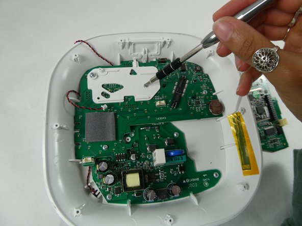

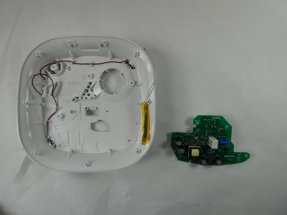

  12. OneLink Safe and Sound Motherboard Replacement: crwdns2935265:012crwdnd2935265:01crwdnd2935265:02crwdne2935265:0 OneLink Safe and Sound Motherboard Replacement: crwdns2935265:012crwdnd2935265:02crwdnd2935265:02crwdne2935265:0
    • Use a Phillips #0 screwdriver to remove seven screws securing the white base and motherboard.

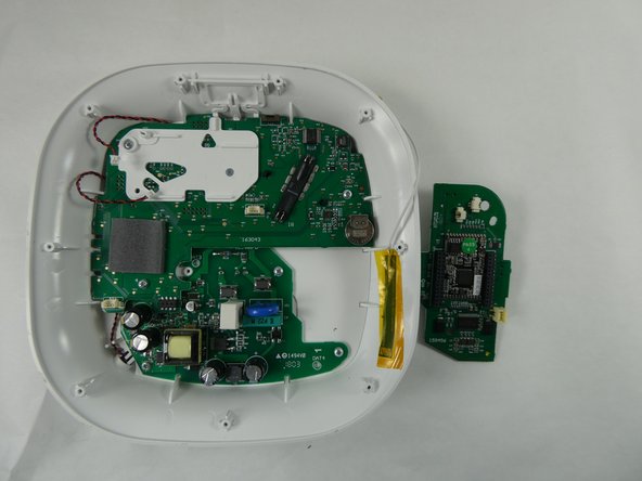

  13. OneLink Safe and Sound Motherboard Replacement: crwdns2935265:013crwdnd2935265:01crwdnd2935265:03crwdne2935265:0 OneLink Safe and Sound Motherboard Replacement: crwdns2935265:013crwdnd2935265:02crwdnd2935265:03crwdne2935265:0 OneLink Safe and Sound Motherboard Replacement: crwdns2935265:013crwdnd2935265:03crwdnd2935265:03crwdne2935265:0
    • Gently remove the motherboard.
