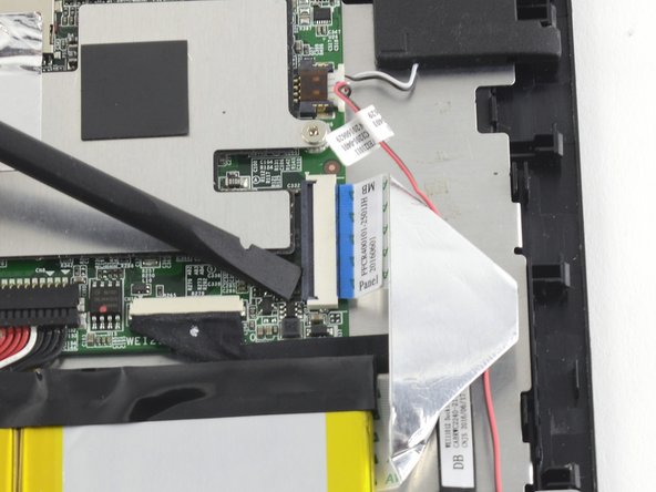

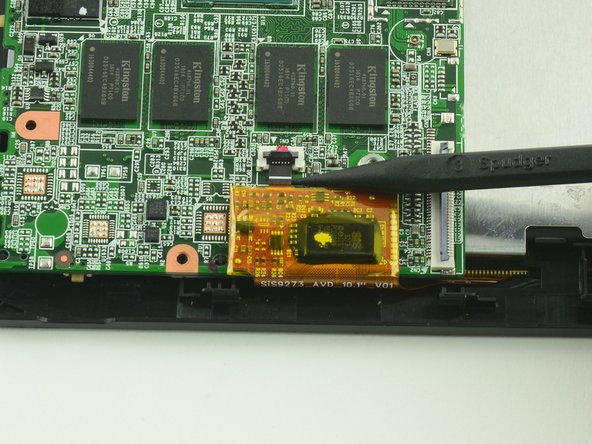

  5. One Education Infinity:One Display Assembly Replacement: crwdns2935265:05crwdnd2935265:01crwdnd2935265:03crwdne2935265:0 One Education Infinity:One Display Assembly Replacement: crwdns2935265:05crwdnd2935265:02crwdnd2935265:03crwdne2935265:0 One Education Infinity:One Display Assembly Replacement: crwdns2935265:05crwdnd2935265:03crwdnd2935265:03crwdne2935265:0

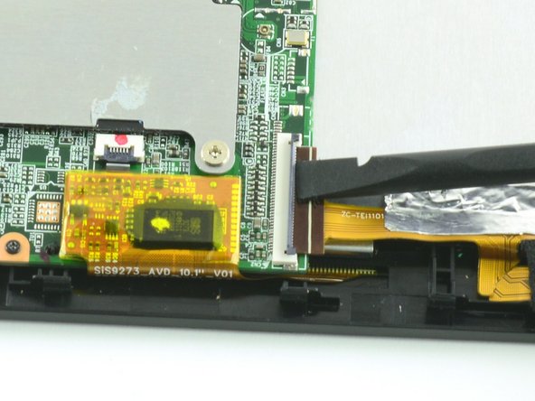

    • Use a spudger to lift the black tab on top of the ZIF connector.
    • Slide the ribbon cable out of the connector.
  6. One Education Infinity:One Display Assembly Replacement: crwdns2935265:06crwdnd2935265:01crwdnd2935265:03crwdne2935265:0 One Education Infinity:One Display Assembly Replacement: crwdns2935265:06crwdnd2935265:02crwdnd2935265:03crwdne2935265:0 One Education Infinity:One Display Assembly Replacement: crwdns2935265:06crwdnd2935265:03crwdnd2935265:03crwdne2935265:0

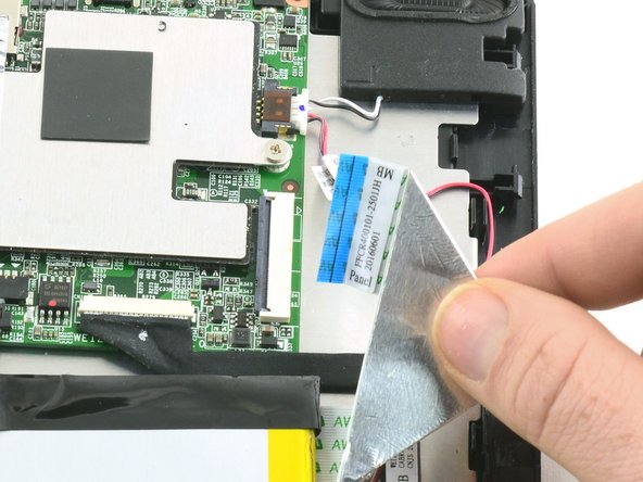

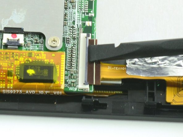

    • Use a spudger to flip up the black retaining flap on the ZIF connector.
    • Pull the folded ribbon cable straight out of the connector.
    • This ribbon cable must be disconnected before removing the battery because it is attached to the battery with adhesive.

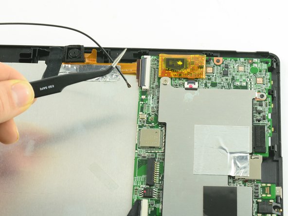

  8. One Education Infinity:One Display Assembly Replacement, Antenna: crwdns2935265:08crwdnd2935265:01crwdnd2935265:02crwdne2935265:0 One Education Infinity:One Display Assembly Replacement, Antenna: crwdns2935265:08crwdnd2935265:02crwdnd2935265:02crwdne2935265:0
    • Use ESD safe tweezers to disconnect the antenna from the motherboard.

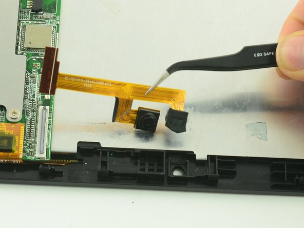

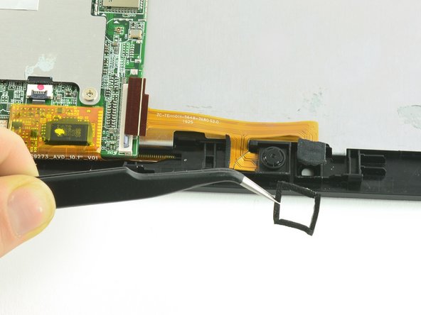

    • Use tweezers to remove the black cushion surrounding the camera lens.
  11. One Education Infinity:One Display Assembly Replacement: crwdns2935265:011crwdnd2935265:01crwdnd2935265:02crwdne2935265:0 One Education Infinity:One Display Assembly Replacement: crwdns2935265:011crwdnd2935265:02crwdnd2935265:02crwdne2935265:0
    • Use tweezers to lift the camera assembly away from the device.
    • Lift straight up to avoid tearing the delicate ribbon cable on the retaining wall.

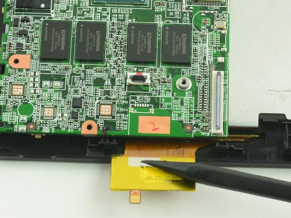

  14. One Education Infinity:One Display Assembly Replacement: crwdns2935265:014crwdnd2935265:01crwdnd2935265:01crwdne2935265:0
    • Use a Phillips #00 screwdriver to unscrew the two 3.4 mm screws.
    • Use a Phillips #000 screwdriver to unscrew the one 4.2mm screw.
  15. One Education Infinity:One Display Assembly Replacement: crwdns2935265:015crwdnd2935265:01crwdnd2935265:01crwdne2935265:0
    • Lift the protective shield away from the motherboard.

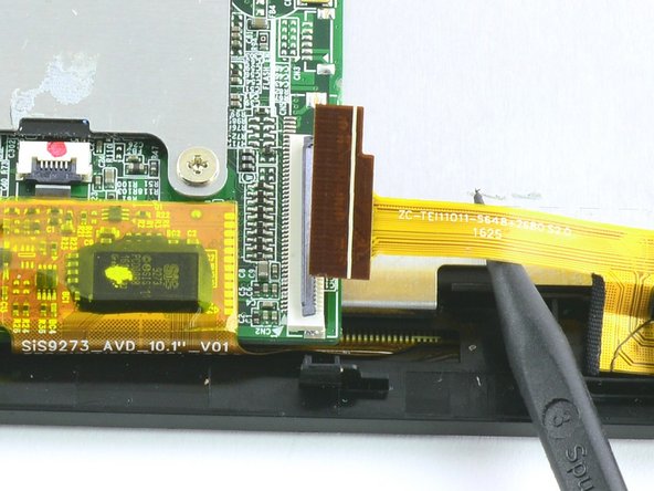

  16. One Education Infinity:One Display Assembly Replacement: crwdns2935265:016crwdnd2935265:01crwdnd2935265:03crwdne2935265:0 One Education Infinity:One Display Assembly Replacement: crwdns2935265:016crwdnd2935265:02crwdnd2935265:03crwdne2935265:0 One Education Infinity:One Display Assembly Replacement: crwdns2935265:016crwdnd2935265:03crwdnd2935265:03crwdne2935265:0
    • With the flat end of a spudger, flip up the black flap on the display's ZIF connector.
    • Insert the pointed end of the spudger between the cable and the motherboard and gently pull the cable straight out of the connector.
    • During reassembly, be sure to insert the cable into the connector up to the white line on the cable and then close the retaining flap.

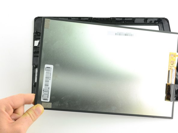

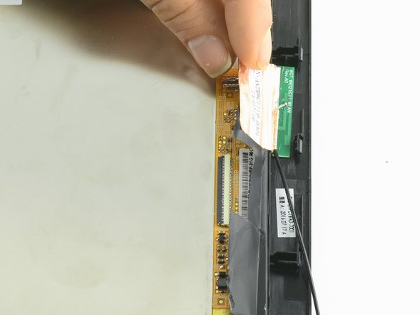

  19. One Education Infinity:One Display Assembly Replacement: crwdns2935265:019crwdnd2935265:01crwdnd2935265:02crwdne2935265:0 One Education Infinity:One Display Assembly Replacement: crwdns2935265:019crwdnd2935265:02crwdnd2935265:02crwdne2935265:0
    • Peel the protective flap away from the display.
  20. One Education Infinity:One Display Assembly Replacement: crwdns2935265:020crwdnd2935265:01crwdnd2935265:02crwdne2935265:0 One Education Infinity:One Display Assembly Replacement: crwdns2935265:020crwdnd2935265:02crwdnd2935265:02crwdne2935265:0
    • Use a spudger to lift the digitizer away from the screen.
    • Grasp the edge of the digitizer and lift straight up to remove.
