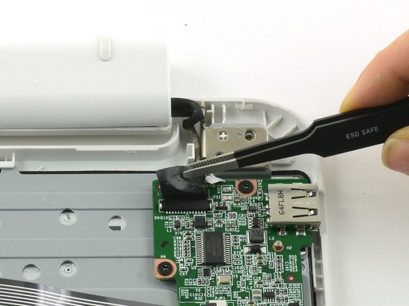

      • Use a spudger to pry the four rubber pads away from the bottom of the case.
      • Use a Phillips #00 screwdriver to unscrew the four 6.4 mm screws.
    2. One Education Infinity:One Back Case Prerequisite: crwdns2935265:02crwdnd2935265:01crwdnd2935265:02crwdne2935265:0 One Education Infinity:One Back Case Prerequisite: crwdns2935265:02crwdnd2935265:02crwdnd2935265:02crwdne2935265:0
      • Insert a Jimmy or other prying tool into the seam on the edge of the casing.
      • Trace along the edges of the device until all clips are released.
      • Lift the back case away from the device.
    3. One Education Infinity:One Back Case Prerequisite: crwdns2935265:03crwdnd2935265:01crwdnd2935265:01crwdne2935265:0
      • Use a Phillips #00 screwdriver to unscrew the four 6.4mm screws on the hinge mounts.
    4. One Education Infinity:One Back Case Prerequisite: crwdns2935265:04crwdnd2935265:01crwdnd2935265:02crwdne2935265:0 One Education Infinity:One Back Case Prerequisite: crwdns2935265:04crwdnd2935265:02crwdnd2935265:02crwdne2935265:0
      • Use tweezers to lift the fabric cover and hinge connector away from the daughterboard.
      • Always use ESD safe tools when working with delicate electrical components.
