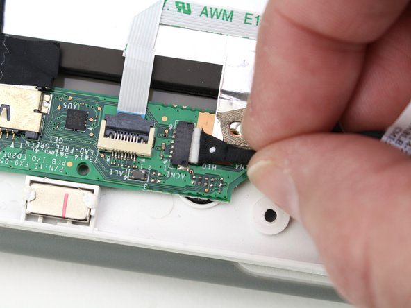

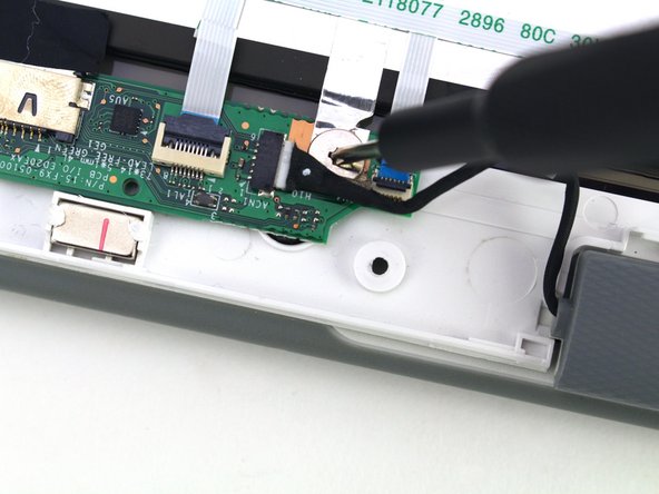

  11. One Education Infinity Webcam Replacement: crwdns2935265:011crwdnd2935265:01crwdnd2935265:02crwdne2935265:0 One Education Infinity Webcam Replacement: crwdns2935265:011crwdnd2935265:02crwdnd2935265:02crwdne2935265:0
    • Remove the silver 2.7 mm screw from the circuit board beside the webcam with a Phillips #00 screwdriver.

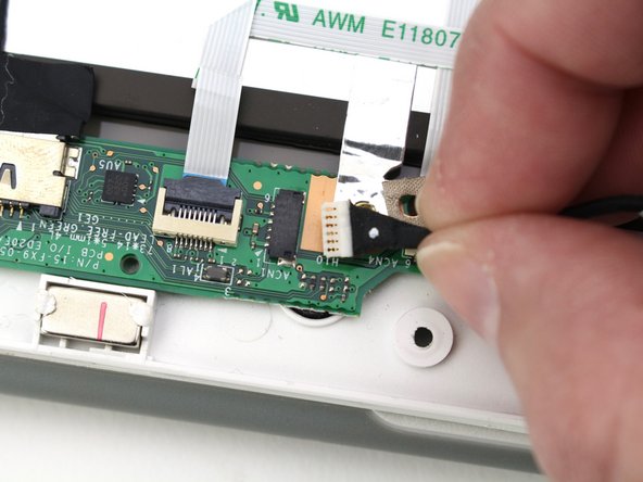

  12. One Education Infinity Webcam Replacement: crwdns2935265:012crwdnd2935265:01crwdnd2935265:03crwdne2935265:0 One Education Infinity Webcam Replacement: crwdns2935265:012crwdnd2935265:02crwdnd2935265:03crwdne2935265:0 One Education Infinity Webcam Replacement: crwdns2935265:012crwdnd2935265:03crwdnd2935265:03crwdne2935265:0
    • Unplug the webcam cable from the circuit board by pulling it horizontally from its connector.
  13. One Education Infinity Webcam Replacement: crwdns2935265:013crwdnd2935265:01crwdnd2935265:01crwdne2935265:0
    • Lift the webcam up from the upper case assembly to remove.
