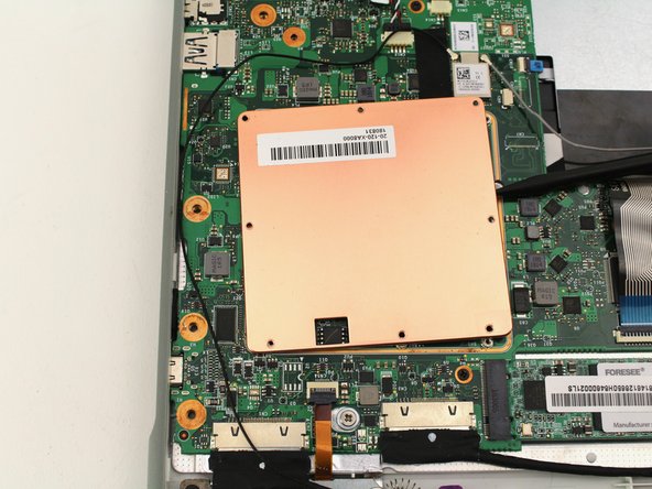

  6. One Education Infinity Heatsink Replacement, Heatsink: crwdns2935265:06crwdnd2935265:01crwdnd2935265:02crwdne2935265:0 One Education Infinity Heatsink Replacement, Heatsink: crwdns2935265:06crwdnd2935265:02crwdnd2935265:02crwdne2935265:0
    • Remove the eight 2.8 mm screws from the heatsink with a Phillips #00 screwdriver.
  7. One Education Infinity Heatsink Replacement: crwdns2935265:07crwdnd2935265:01crwdnd2935265:03crwdne2935265:0 One Education Infinity Heatsink Replacement: crwdns2935265:07crwdnd2935265:02crwdnd2935265:03crwdne2935265:0 One Education Infinity Heatsink Replacement: crwdns2935265:07crwdnd2935265:03crwdnd2935265:03crwdne2935265:0
    • Insert the tip of a spudger into the small gap along the right side edge of the heatsink and pry upward to free it from the clips.
  8. One Education Infinity Heatsink Replacement: crwdns2935265:08crwdnd2935265:01crwdnd2935265:01crwdne2935265:0
    • Lift the heatsink up from the motherboard.
