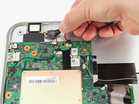

  6. One Education Infinity CMOS Battery Replacement, CMOS Battery: crwdns2935265:06crwdnd2935265:01crwdnd2935265:03crwdne2935265:0 One Education Infinity CMOS Battery Replacement, CMOS Battery: crwdns2935265:06crwdnd2935265:02crwdnd2935265:03crwdne2935265:0 One Education Infinity CMOS Battery Replacement, CMOS Battery: crwdns2935265:06crwdnd2935265:03crwdnd2935265:03crwdne2935265:0
    • Use a plastic spudger to slide out the cable connector attached to the CMOS battery from the motherboard.

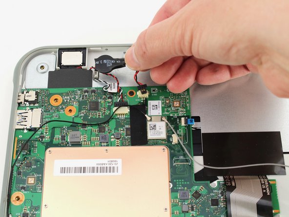

  7. One Education Infinity CMOS Battery Replacement: crwdns2935265:07crwdnd2935265:01crwdnd2935265:03crwdne2935265:0 One Education Infinity CMOS Battery Replacement: crwdns2935265:07crwdnd2935265:02crwdnd2935265:03crwdne2935265:0 One Education Infinity CMOS Battery Replacement: crwdns2935265:07crwdnd2935265:03crwdnd2935265:03crwdne2935265:0
    • Peel the CMOS battery gently from the back case, as there is a layer of light adhesive holding it down.
    • Remove the CMOS battery.
