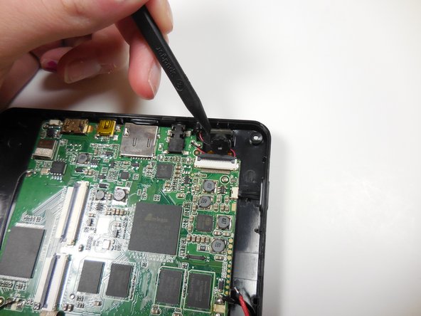

    1. Onda V701 Front- Facing Camera Replacement, Front- Facing Camera: crwdns2935265:06crwdnd2935265:01crwdnd2935265:02crwdne2935265:0 Onda V701 Front- Facing Camera Replacement, Front- Facing Camera: crwdns2935265:06crwdnd2935265:02crwdnd2935265:02crwdne2935265:0
      • Gently pry the front-facing camera away from the back panel using a spudger.

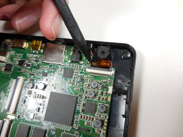

    2. Onda V701 Front- Facing Camera Replacement: crwdns2935265:07crwdnd2935265:01crwdnd2935265:02crwdne2935265:0 Onda V701 Front- Facing Camera Replacement: crwdns2935265:07crwdnd2935265:02crwdnd2935265:02crwdne2935265:0
      • Flip the gray locking tab of the ribbon connector up using a spudger.
      • Remove the ribbon cable from the connector.
    3. Onda V701 Front- Facing Camera Replacement: crwdns2935265:08crwdnd2935265:01crwdnd2935265:01crwdne2935265:0
      • Remove the front-facing camera assembly.
