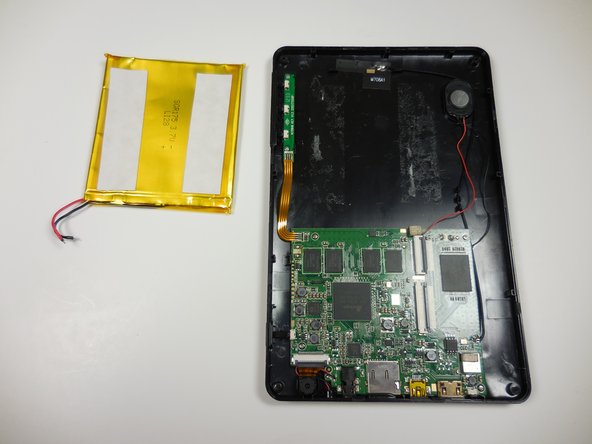

  6. Onda V701 Battery Replacement, Battery: crwdns2935265:06crwdnd2935265:01crwdnd2935265:01crwdne2935265:0
    • Desolder the red(+) and black(-) wires connecting the battery to the motherboard using a soldering iron and tweezers to hold the wire.
    • Soldering requires a lot of heat. Do not touch the metal part of the soldering iron. Wear gloves if necessary to protect your hands. The fumes from soldering could also be toxic. Work in a well ventilated area and/or use a respirator.

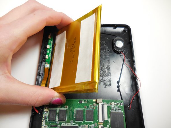

  7. Onda V701 Battery Replacement: crwdns2935265:07crwdnd2935265:01crwdnd2935265:03crwdne2935265:0 Onda V701 Battery Replacement: crwdns2935265:07crwdnd2935265:02crwdnd2935265:03crwdne2935265:0 Onda V701 Battery Replacement: crwdns2935265:07crwdnd2935265:03crwdnd2935265:03crwdne2935265:0
    • Carefully pry the battery away from the back panel using the nylon or metal spudger.
    • Gently remove the battery from the back panel.
    • Ensure not to excessively bend or puncture the battery. Doing so could cause the battery to catch on fire or explode.
