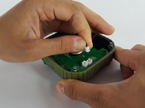

  5. Omaker M4 Port Cover Replacement: crwdns2935265:05crwdnd2935265:01crwdnd2935265:02crwdne2935265:0 Omaker M4 Port Cover Replacement: crwdns2935265:05crwdnd2935265:02crwdnd2935265:02crwdne2935265:0
    • Remove the end of the battery connection from the motherboard by holding the end of the wire and carefully pulling it out of the socket using tweezers.
    • The battery is still attached to the back cover.

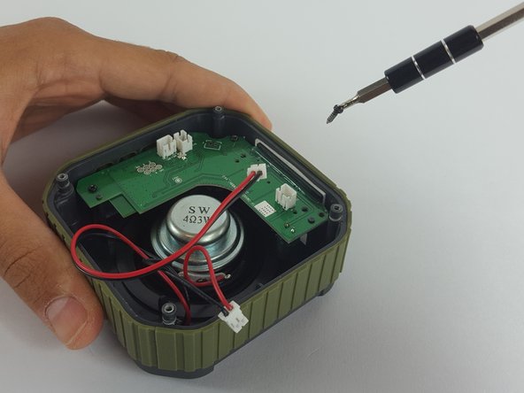

  6. Omaker M4 Port Cover Replacement, Motherboard: crwdns2935265:06crwdnd2935265:01crwdnd2935265:02crwdne2935265:0 Omaker M4 Port Cover Replacement, Motherboard: crwdns2935265:06crwdnd2935265:02crwdnd2935265:02crwdne2935265:0
    • Remove the mic wire by carefully pulling the plug out of the socket.
  7. Omaker M4 Port Cover Replacement: crwdns2935265:07crwdnd2935265:01crwdnd2935265:01crwdne2935265:0
    • Remove the speaker wire by carefully pulling the plug out of the socket on the motherboard.

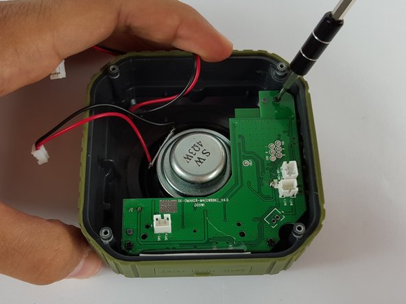

  8. Omaker M4 Port Cover Replacement: crwdns2935265:08crwdnd2935265:01crwdnd2935265:02crwdne2935265:0 Omaker M4 Port Cover Replacement: crwdns2935265:08crwdnd2935265:02crwdnd2935265:02crwdne2935265:0
    • Use Phillips PH00 screwdriver to remove the three screws holding the motherboard in place.
  9. Omaker M4 Port Cover Replacement: crwdns2935265:09crwdnd2935265:01crwdnd2935265:02crwdne2935265:0 Omaker M4 Port Cover Replacement: crwdns2935265:09crwdnd2935265:02crwdnd2935265:02crwdne2935265:0
    • Remove the screws using the screwdriver.
    • Since the screws that hold the motherboard in place are smaller, the screwdriver is able to pick them up.

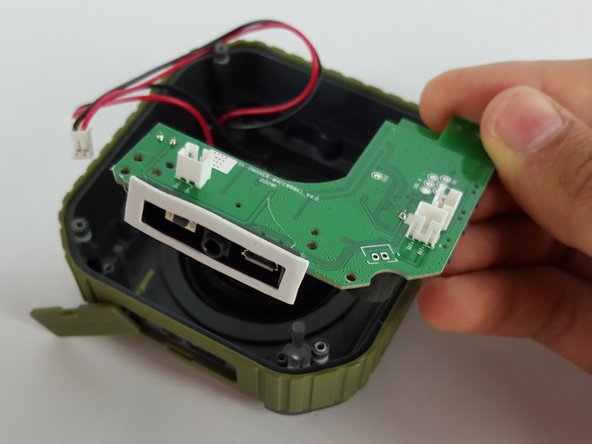

  10. Omaker M4 Port Cover Replacement: crwdns2935265:010crwdnd2935265:01crwdnd2935265:02crwdne2935265:0 Omaker M4 Port Cover Replacement: crwdns2935265:010crwdnd2935265:02crwdnd2935265:02crwdne2935265:0
    • Carefully remove the motherboard with your hand by lifting it from the device.

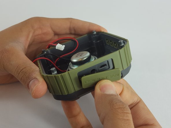

  11. Omaker M4 Port Cover Replacement, Port Cover: crwdns2935265:011crwdnd2935265:01crwdnd2935265:02crwdne2935265:0 Omaker M4 Port Cover Replacement, Port Cover: crwdns2935265:011crwdnd2935265:02crwdnd2935265:02crwdne2935265:0
    • Separate the port cover from the device using your hands.
  12. Omaker M4 Port Cover Replacement: crwdns2935265:012crwdnd2935265:01crwdnd2935265:01crwdne2935265:0
    • Orient the device so the port cover is on your left.
  13. Omaker M4 Port Cover Replacement: crwdns2935265:013crwdnd2935265:01crwdnd2935265:02crwdne2935265:0 Omaker M4 Port Cover Replacement: crwdns2935265:013crwdnd2935265:02crwdnd2935265:02crwdne2935265:0

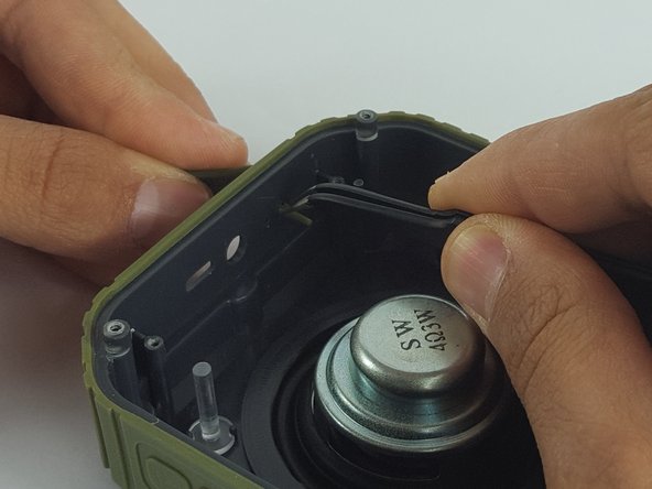

    • Using Tweezers, pinch the larger part of the stem
  14. Omaker M4 Port Cover Replacement: crwdns2935265:014crwdnd2935265:01crwdnd2935265:01crwdne2935265:0
    • Use your left hand to pull while at the same time use the tweezers to compress the stem, carefully remove the port cover from the device.
