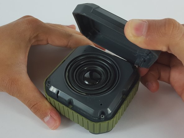

The front case of the Omaker M4 provides a protective layer for the speaker cone. Once the front case is removed, the speaker can be accessed.
    1. Omaker M4 Front Case Replacement, Front Case: crwdns2935265:01crwdnd2935265:01crwdnd2935265:01crwdne2935265:0
      • Flip the device over so the front of the device is facing upwards. Make sure to place the speaker on a flat surface
    2. Omaker M4 Front Case Replacement: crwdns2935265:02crwdnd2935265:01crwdnd2935265:02crwdne2935265:0 Omaker M4 Front Case Replacement: crwdns2935265:02crwdnd2935265:02crwdnd2935265:02crwdne2935265:0
      • Use a T6 Torx Screwdriver to remove the four screws from the front of the device.
    3. Omaker M4 Front Case Replacement: crwdns2935265:03crwdnd2935265:01crwdnd2935265:01crwdne2935265:0
      • Use a magnet to remove the screws after unscrewing them and place them aside.
    4. Omaker M4 Front Case Replacement: crwdns2935265:04crwdnd2935265:01crwdnd2935265:02crwdne2935265:0 Omaker M4 Front Case Replacement: crwdns2935265:04crwdnd2935265:02crwdnd2935265:02crwdne2935265:0
      • Carefully remove the front case by gently pulling it from the body of the device.
