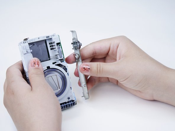

    1. Olympus VR-350 Power Button Replacement, Power Button: crwdns2935265:05crwdnd2935265:01crwdnd2935265:02crwdne2935265:0 Olympus VR-350 Power Button Replacement, Power Button: crwdns2935265:05crwdnd2935265:02crwdnd2935265:02crwdne2935265:0
      • Remove the silver panel from the top of the camera.
    2. Olympus VR-350 Power Button Replacement: crwdns2935265:06crwdnd2935265:01crwdnd2935265:01crwdne2935265:0
      • Flip the silver panel over. The power button is the smaller button covered by a metal backing.
    3. Olympus VR-350 Power Button Replacement: crwdns2935265:07crwdnd2935265:01crwdnd2935265:01crwdne2935265:0
      • Pull the metal backing away from the silver panel.
    4. Olympus VR-350 Power Button Replacement: crwdns2935265:08crwdnd2935265:01crwdnd2935265:01crwdne2935265:0
      • Push the power button down and out of the silver panel with your finger.
