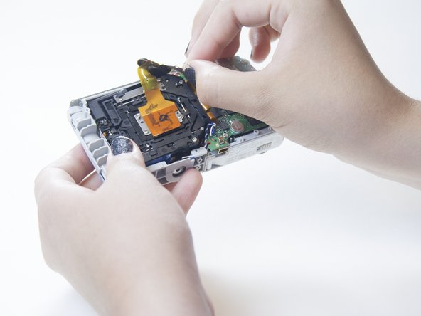

    1. Olympus VR-350 Lens Box Unit Replacement, Lens Box Unit: crwdns2935265:08crwdnd2935265:01crwdnd2935265:01crwdne2935265:0
      • Remove the metal plate that was underneath the LCD screen by removing the four 4 mm screws with the Phillips PH000 screwdriver.
    2. Olympus VR-350 Lens Box Unit Replacement: crwdns2935265:09crwdnd2935265:01crwdnd2935265:02crwdne2935265:0 Olympus VR-350 Lens Box Unit Replacement: crwdns2935265:09crwdnd2935265:02crwdnd2935265:02crwdne2935265:0
      • Remove the orange ribbon cable from the connector on the left side of the motherboard.
      • To do this, gently lift up the small grey clasp and pull the cable ribbon.
    3. Olympus VR-350 Lens Box Unit Replacement: crwdns2935265:010crwdnd2935265:01crwdnd2935265:01crwdne2935265:0
      • There are two other small ribbon cables under the motherboard connected to the lens box. Pull them out from the motherboard.
      • You may need to use force to pull out the ribbon cables.
    4. Olympus VR-350 Lens Box Unit Replacement: crwdns2935265:011crwdnd2935265:01crwdnd2935265:01crwdne2935265:0
      • Pull the lens box up and out to remove it.
