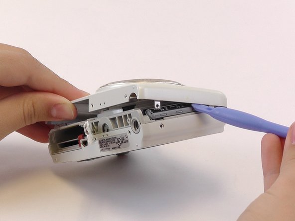

  3. Olympus VR-350 Back Plate Replacement: crwdns2935265:03crwdnd2935265:01crwdnd2935265:03crwdne2935265:0 Olympus VR-350 Back Plate Replacement: crwdns2935265:03crwdnd2935265:02crwdnd2935265:03crwdne2935265:0 Olympus VR-350 Back Plate Replacement: crwdns2935265:03crwdnd2935265:03crwdnd2935265:03crwdne2935265:0
    • Use the plastic opening tools and your fingers to pry the front plate from the camera.
    • You might need to open the battery cover to remove the front plate.

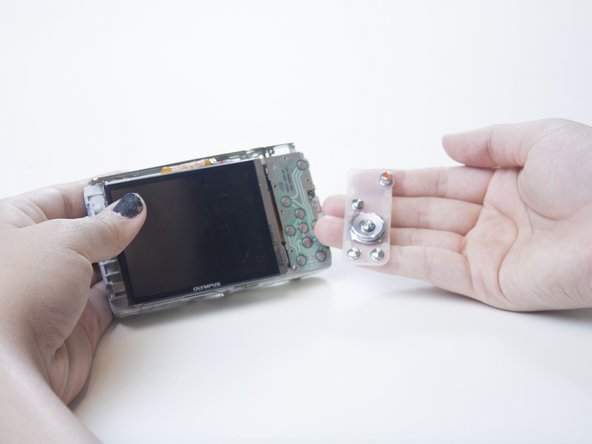

  4. Olympus VR-350 Back Plate Replacement, Back Plate: crwdns2935265:04crwdnd2935265:01crwdnd2935265:02crwdne2935265:0 Olympus VR-350 Back Plate Replacement, Back Plate: crwdns2935265:04crwdnd2935265:02crwdnd2935265:02crwdne2935265:0
    • Use your fingers to pry open the back cover.
    • When you remove the back of the camera, the button membrane might fall out. Don’t lose this sheet.
    • The LCD screen is connected to the body of the camera by an orange ribbon cable. Don’t pull this ribbon cable out.
