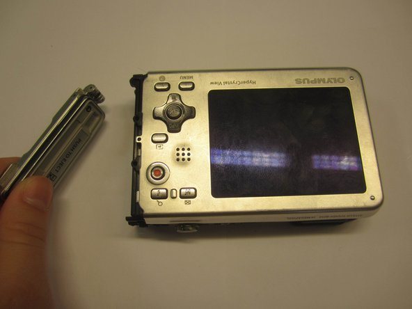

  3. Olympus Stylus Tough-8010 Side Panel Replacement: crwdns2935265:03crwdnd2935265:01crwdnd2935265:03crwdne2935265:0 Olympus Stylus Tough-8010 Side Panel Replacement: crwdns2935265:03crwdnd2935265:02crwdnd2935265:03crwdne2935265:0 Olympus Stylus Tough-8010 Side Panel Replacement: crwdns2935265:03crwdnd2935265:03crwdnd2935265:03crwdne2935265:0
    • Using a #000 Philips head screwdriver, remove the two screws (4.1mm) on the right side of the camera.
    • Remove the two screws (4.1mm) from the bottom of the camera.
    • Remove the single screw (3.2mm) from the front of the camera.

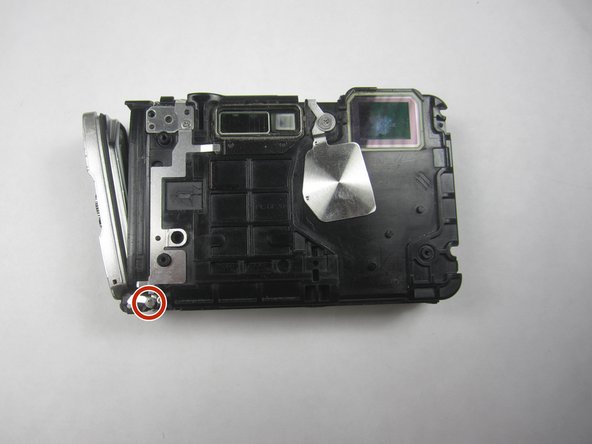

  4. Olympus Stylus Tough-8010 Side Panel Replacement: crwdns2935265:04crwdnd2935265:01crwdnd2935265:02crwdne2935265:0 Olympus Stylus Tough-8010 Side Panel Replacement: crwdns2935265:04crwdnd2935265:02crwdnd2935265:02crwdne2935265:0
    • Carefully remove the front panel piece.
    • Remove the screw (7.9mm) from the bottom left hand corner using a #000 Phillips head screwdriver.

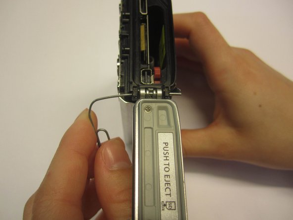

  5. Olympus Stylus Tough-8010 Side Panel Replacement: crwdns2935265:05crwdnd2935265:01crwdnd2935265:03crwdne2935265:0 Olympus Stylus Tough-8010 Side Panel Replacement: crwdns2935265:05crwdnd2935265:02crwdnd2935265:03crwdne2935265:0 Olympus Stylus Tough-8010 Side Panel Replacement: crwdns2935265:05crwdnd2935265:03crwdnd2935265:03crwdne2935265:0
    • Slightly bend the metal that is covering the side panel axle.
    • Using a paperclip, completely push out the metal bar that holds the side panel to the camera.
    • Remove the side panel door.
